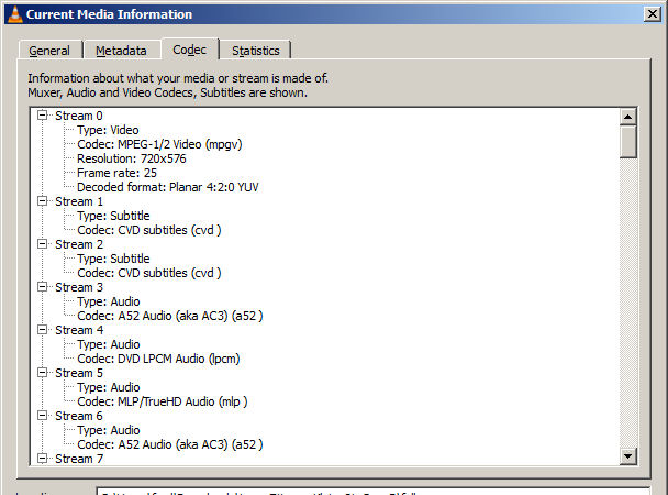

    My Sony camcorder uses Fat32 as its filesystem, so records files as 2GB MPEG files* that I need to join prior to editing.
    I've tried the following tools for Windows, which all have issues:
    • ffmpeg : When played in VLC, no sound and lots of video streams:
      c:\>ffmpeg -i "concat:file1.mpg|file2.mpg" -c copy full.mpeg
      (see attachment for an illustration)

    The concat protocol of ffmpeg concatenates the files themselves. Try the concat demuxer which joins the streams.
    Like this:
    ffmpeg -f concat -i mylist.txt -c copy output

  9. If you are using mpeg2 : copy /b file1.mpg+file2.mpg output.mpg
    I've used that for 15 years+ with no problems (in a .bat file for simplicity).
    Failing that virtualDubMod every time.
    As mentioned above this just cats the files but it should work with mpeg2 if your reader handles
    files in a standard manner. If it doesnt I'd look for different software to avoid issues down the line.
