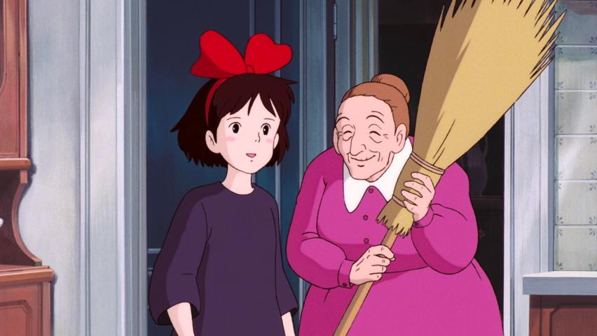

  1. I bought a Blu-Ray but the colors are different than the DVD or the video tape I have of this movie.
    For instance I'm used to a woman's hair being brown but in this new Blu-Ray it looks red. (First example)
    It kind of looks like theres a slight blue tint over everything in the Blu-Ray
    I'm not sure which is the more correct colors but I am used to how my DVD and video tape have them and would like a few suggestions on how to adjust or fix using AVISynth to get them looking more like the DVD colors with maybe a bit less brightness.
    I tried tweak(hue=-6) and it helped the hair color on the woman in the first example but it looks off or the colors are thrown off in other scenes from the looks of it. The skin tones seem to be the most noticeable.
    Here are some comparison screenshots.
    BLU-RAY
    BLU-RAY -6 Hue
    DVD
    BLU-RAY
    BLU-RAY -6 Hue
    DVD
    BLU-RAY
    BLU-RAY -6 HUE
    DVD

  11. Okay this is officially weird and I have no idea whats going on here.
    I just watched my M2TS file in 3 different media players and 2 different computers and it looks great but when I try to encode it, using any method at all, the colors get all screwed up like in the pictures above. This is happening even if I do not add any filters at all in the script so its not a filter Im using.
    It seems the .M2TS file the colors are exactly how I wanted them and already close to the DVD colors. Whats up with that?
    I have never had this happen before and I have encoded many of my DVD's for myself and a few Blu-Rays. Why would this be doing this?

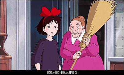

    Some colors are better but some are still off:
    It's way off with the other shots though.
