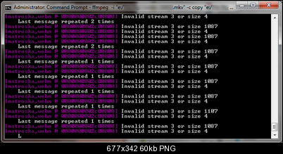

  3. Thank man, that seems to have done the trick. Even though throughout the muxing process following error messages kept appearing:
    The file is now perfectly playable on external devices so that solves my problem. Thanks again for the useful tip!
