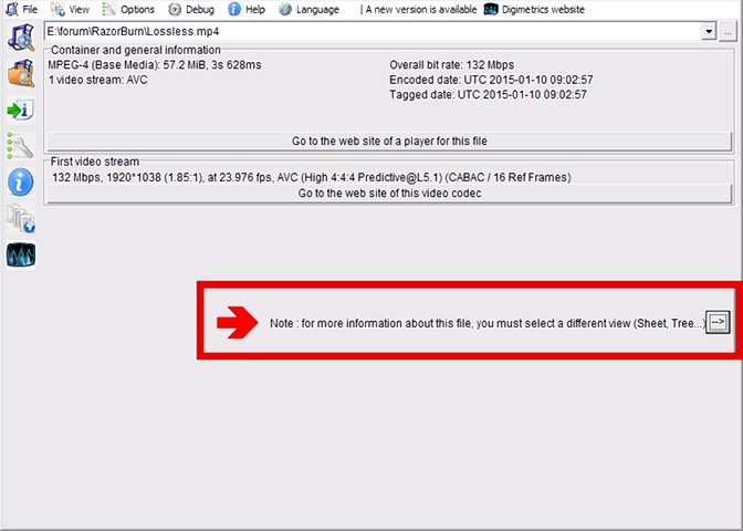

    Did you ever notice this in the MediaInfo window? ---
Name:	Have You Noticed.png
    In "Text" view you'll see a full page of details about your video. The data in Text View can be copied and pasted into this forum as text. It's very high-tech.
    Sorry, these abbreviated screen caps from MediaiInfo are getting annoying.
