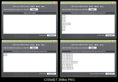

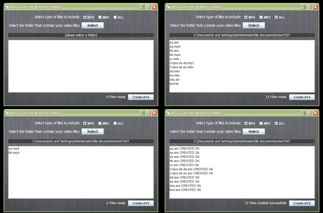

    Here some Screenshots:
    Notes: It will create an .avs file for every .mp4 or .mkv or all files, depending on what you selected, with a content like this.
    DirectShowSource("<your selected folder>\<filename>.<extension>")
    Example:
    DirectShowSource("C:\Documents and Settings\Admin\Videos\Video.mp4")
    You can download it here (Available in .exe .jar and .rar with both formats)
