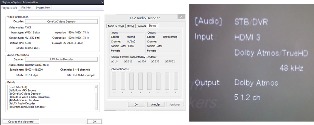

    I.m having trouble bitstreaming DTS-HD MA audio track to my receiver. It looks like it's detected as a regular DTS. (see picture)
    Dolby TrueHD Atmos 7.1 works perfectly, so i dont get why i cant see the DTS-HD MA logo in my receiver .
    also when i play 7.1 dts-hd MA track , its detected as 5.1
    any idea why. ..... Am I doing something wrong ?

Name:	dts-hd montage.jpg
Name:	atmos montage.jpg

    thanks for your reply.
    yes my sound card support dts-hd ma .
    it seems to be a problem with my configuration of potplayer because I just tried MPC-HC and everything works.
