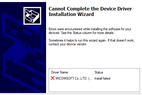

    Hello. I'm trying to install "Micomsoft USB3HDCAP Drivers" by The Thrillness and the installation keeps failing. I've uninstalled all previous drivers that I had through my device manager and it's still not working. I'm using Windows 10.
    This is the error I'm getting.
    [Attachment 41880 - Click to enlarge]
    Any ideas? Thanks.

    According to the information previously included in this thread the original provider of the driver for capture cards like the Yuan UB-530 , Micomsoft Xcapture-1, Startech usb3hdcap and others with the same chipset is YUAN.
    I Think the eventual advantages to use the Micomsoft driver in the past was they were relatively fast updated (after YUAN)faster then startech and the fact that it was posted a method to adapt the micomsoft driver allowing an unsigned driver to be installed.
    However the Have disk method avoiding the need to adjust the driver and allowing to install unsigned drivers should allow yuan , micomsoft and others to be installed with the startech if you do have access to the driver files namely the inf file, not always the case( Yuan is an exe file).
    But now the drivers are almost all stabilized within the same and last version and probably there is no advantage to use the micomsoft driver already ( also it seems not updated to the last version), only if the last startech driver version has some type of known specific error

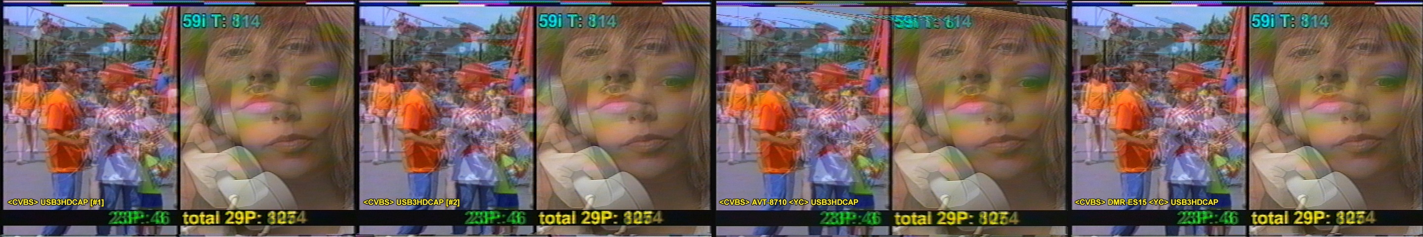

    Yesterday, I captured a prototype version of a test pattern tape I made. I'll probably never get around to really analyzing the results, as it quickly becomes super complex and boring. But here is an example of the AVT-8710 causing flagging in one field, while capturing direct to the card is actually fine on this frame. It did this several times at the start of this tape, where I had intentionally stopped and started the recording every few seconds. (The tape is a reused pre-record: E.T.)
Name:	US.A-V.S__v1.0 - SLV-779HF (-APC, SH 1^4) - TBC test results000533.jpg
    In this case, the tape apparently contains two top fields in a row instead of top & bottom, due to the location of the "cut". How each devices deals with this error differs. The DMR-ES15 seems to take longer to recover, but doesn't introduce flagging. Meanwhile, it skips frames for no apparent reason at times. I believe its internal clock is inaccurate.

    I've tried processing one full recording and have run into an issue with the de-interlacing using QTGMC on the Slow preset.
    I will attach a copy of a clip from the from the recording but as you can see there is constant shaking all over the clip which looks too me like the interlacing has failed. I'm really not sure what to do in order to fix this as I've used these same StaxRip settings on a recording done with my previous capture device without issue, it's just a simple cut to eliminate garbage frames captured at the start and end, QTGMC on slow and then a H.264 pass with the Medium preset and Film Tune. All of this is being done at 12Mbps.
    Should I be using something else to do the encode or is the problem with the capture?
