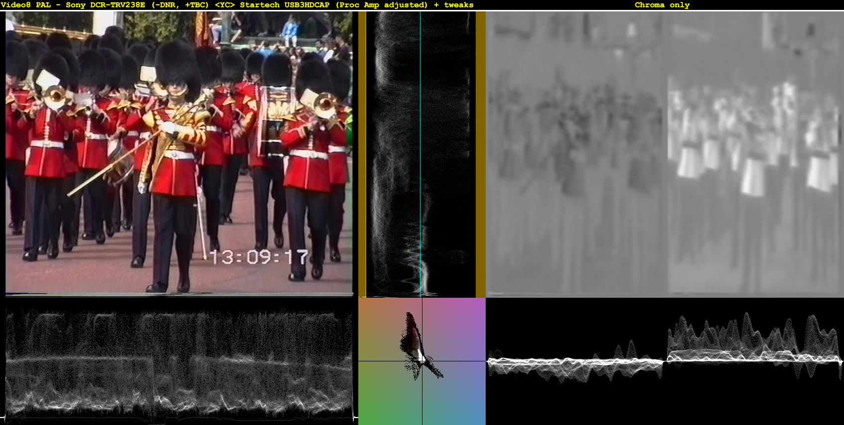

    Originally Posted by LMotlow View Post
    Notice how red turns bright green every time a red uniform enters a certain area along the right border. I suspect that's in the original, too.
    I mentioned on DigitalFAQ, this particular issue seems to be specific to the playback device, namely some/all PAL Digital8 camcorders: https://forum.videohelp.com/threads/354425-Hi8-capture-using-Digital8-camcorder-Edge-co...=1#post2227547
    As far as broken lines and aliasing, I'm not sure that you've demonstrated anything more than the problems with interlaced content in general. Do you have an example of interlaced video where a shaking camera is zooming in along a diagonal line without these issues?

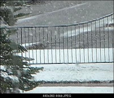

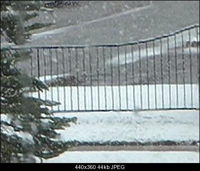

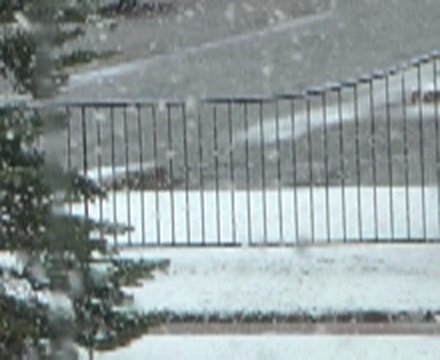

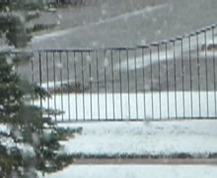

    Here is a 480i frame I generated by downscaling a 1080p60 camcorder video and interlacing it. Lines are similarly broken.
    2x:
    Bob() 2x:
ID:	31840Click image for larger version
    QTGMC() 2x:
ID:	31842Click image for larger version
    I purposely gimped QTGMC here by inputting the PNG rather than the video. If given the generated video, its motion compensation allows it to fill everything in better because the movement is smaller and the video has much less noise than the Video8 example. Hopefully the point is still clear.

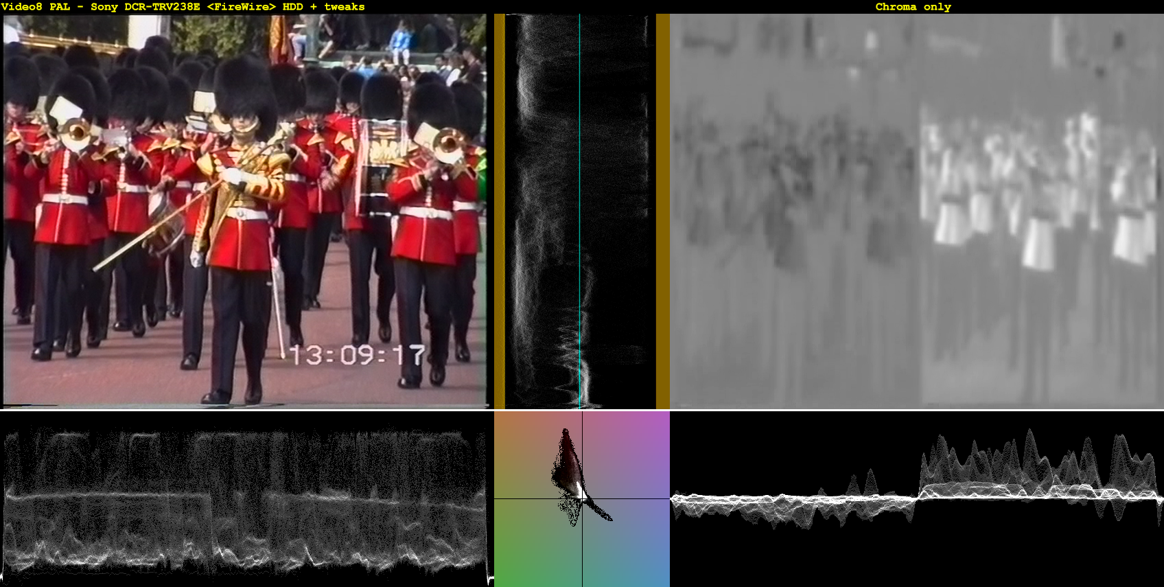

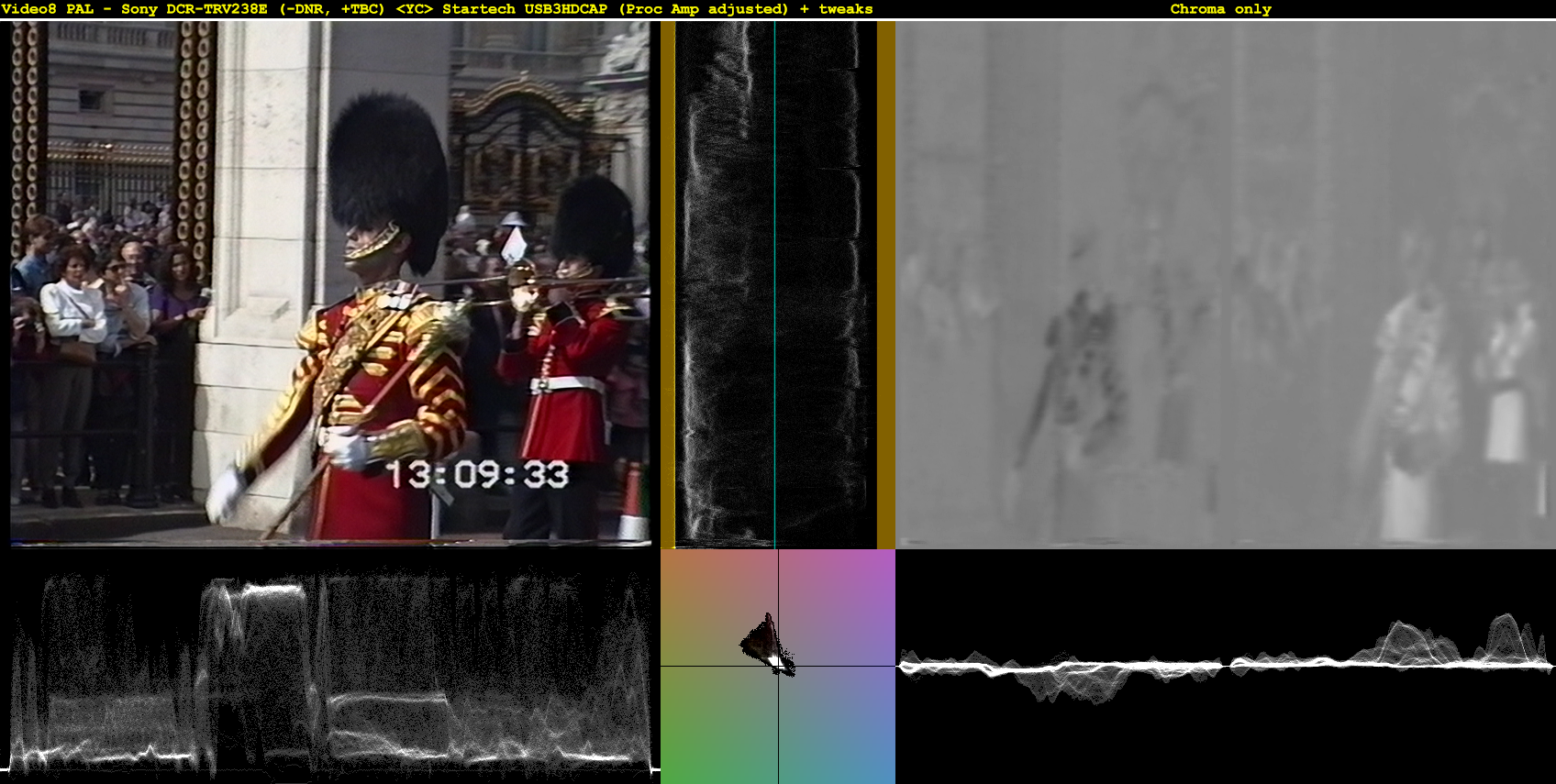

    Thank you vaporeom800 and LMotlow for the effort done in interpreting the usb3hdcap capture data.
    I think that both of you, although having minor differences opinions regarding interpretation of some data, are apparently in agreement that the problems found in the captures are source related ( tape/ camera problems) and not introduced by the capture device itself and that, the capture device is in some way neutral not introducing by itself additional problems , artifacts , whatever.
    As I´m not able to find none of these “ wonder” legacy ATI cards ,and I have to choose the best I can get ,I was really interested to find if this device could be my best choice without going for professional stuff like the AJA KONA, BlueFish or similar cards for capturing analog tapes who may have in addition to the excessive price particular problems ( even knowing this device is gamers market oriented , but with retro gamers also in mind ,that´s why the analog conversion was included).
    I´m posting the samples I previous referred, a D8 firewire direct capture of the same clip .If the problems are tape/camera related they also must be there.
    I tried also with some old capture devices owned (unfortunately not very good quality), Philips Saa7134 perhaps the best of this lot, Dazzle DVC100, pinnacle PC TV usb, Hauppage WinTv 878/9 and it seems to me that the problems are always present independently of the capture device used.
    I ´m also posting a video8 sample capture from the camcorder early days when it was still new and a clip with less motion (pan and zoom ) that perhaps will show off less problems.
    It would be nice if we can conclude ,if it is or not a satisfactory device for analog tapes captures or if I still need to continue searching for a new one.

  13. Formerly 'vaporeon800' Brad's Avatar
    Apr 2001
    Vancouver, Canada
    Thanks for the input, but your example doesn't deal with what I referred to. No one is rescaling here. I don't see why you're posting a "480i frame generated from a 1080p60". How is this relevant?
    Oh, I thought it was obvious: starting from a pure progressive source without the problem, and seeing whether the problem appears when half of the lines are thrown away by interlacing. If it does, that would be evidence that it's a general issue with interlaced formats.
    But it doesn't fly to pieces with exploding psychotic pixels every time something moves.
    Thank goodness my screen isn't exploding with psychotic pixels.
    Thank you for humoring me with the sample, LMotlow. I'll table my thoughts on it for now, if that's okay, as I'm more interested in discussing this DV sample that you uncharacteristically praised.
    Here is one QTGMC'd field from the frame you showed earlier to exemplify broken lines. The portion of the column that you showed at 2x looks the same in both to me, except for the very edge where it meets his arm. The next field doesn't even have that distinction. Are you seeing something different?
Name:	FLP347 - Video8 sample 1 - Field 1232 A.png
ID:	31888 Click image for larger version
Name:	FLP347 - Video8 sample 1 - Field 1232 B.png

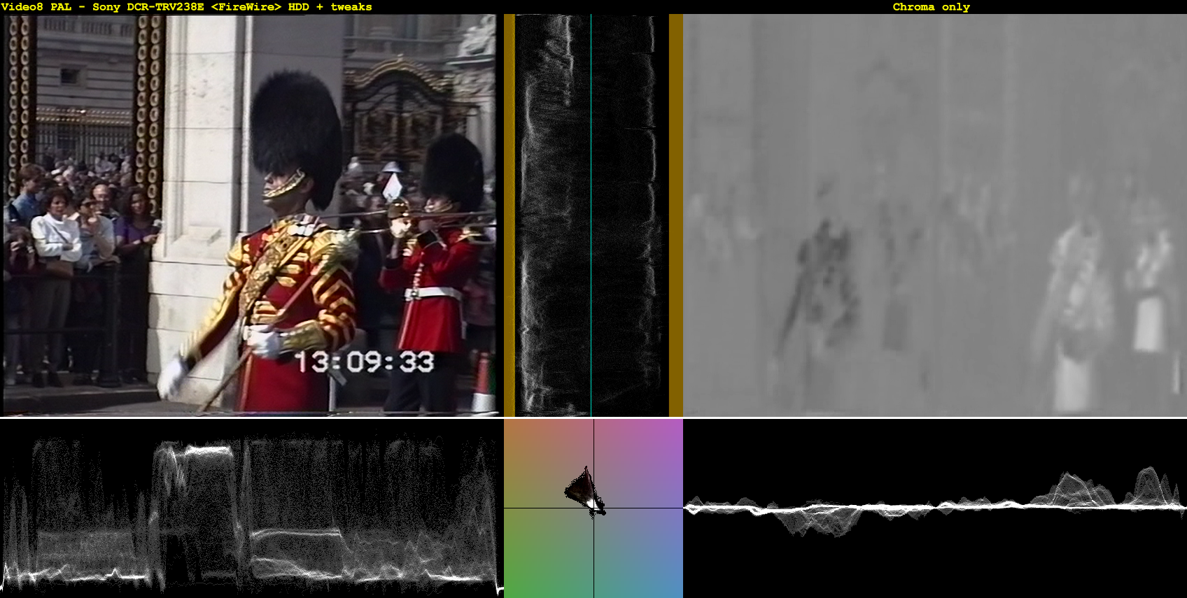

    On the DV I see mosquito noise, some blocking, associated loss of detail on the metal archway to the right, a difference in chroma placement, and blocky chroma (on the UV-only view). On the Huffyuv I see additional noise, and notably edge noise that isn't visible in the DV since it's replaced with mosquito noise. (To be clear, my comparison was done at 2x, not the 1:1 magnification seen here.)
    Here is a different frame where you may agree that the Huffyuv holds up better (the man in the middle).
Name:	FLP347 - Video8 sample 1 - Field 448 A.png
ID:	31890 Click image for larger version
Name:	FLP347 - Video8 sample 1 - Field 448 B.png
    The "tweaks" are an attempt to match levels:
    AssumeTFF().ColorYUV(off_y=-8,cont_u=-20,cont_v=-13).QTGMC().Trim(2,0) #USB3HDCAP
    ColorYUV(gain_y=-31).QTGMC() #DV

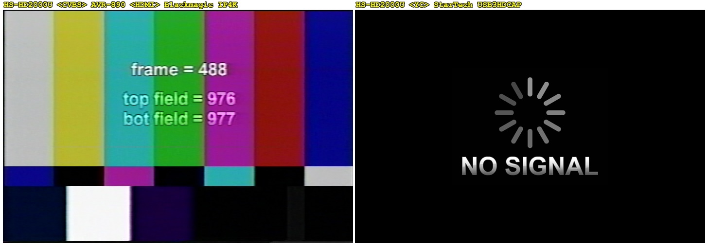

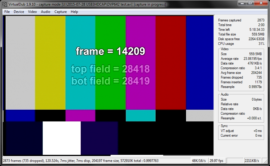

    One minor con with the USB3HDCAP is that it doesn't capture all lines available for PAL video. You lose 2.5 lines at the top and gain 3 lines of nothingness at the bottom. But your TV7134 does the same thing.

    vaporeon800, could you please help with this points.
    As I have for now no other option If I want a HuffYUV lossless capture file, I have to use the usb3hdcap or the philips Saa7134 , if not I have to stay with the previous DV captures I´m trying to see if i can make any small improvements in the captures with the startech device.
    Related to the capture pin properties - I frames interval
    is the default value (30 ) the best one or a smaller value (15 ) could improve capture results?
    As I got some chroma problems in the captures and namely chroma bleeding could the the DNR on in the camcorder help?
    I turned off DNR and TBC because I got the impression of a less detailed captured image . But has the device is much less prone to drop frames than the philips ( with this one a external tbc is almost mandatory if not there are a lot of drop frames) perhaps some tweaks could improve the captures.
    thanks,
    Image Attached Images
  24. Formerly 'vaporeon800' Brad's Avatar
    Apr 2001
    Vancouver, Canada
    I don't believe the I Frame Interval and Quality options there actually do anything. You could try cranking the Interval as high as it goes and the Quality as low as it goes to see whether any setting has an effect towards degrading the image.
    In my opinion, the camera is DNRing the chroma regardless of the DNR setting being off or on; turning it "on" doesn't seem to improve things further.
    I think you're getting the best you can get, so long as you set the Proc Amp appropriately for each capture.

    Well the idea was a little crazy but yes changing The I frame Interval works , for worst . I tried only decreasing the I Frame interval for 15 and I got lots of inserted frames. So it seems I´m getting the best I can probably . The TBC and DNR circuits on the camcorder seem to have virtually no effect I´m beginning to think if they are working properly , but I also don't get better results from my video8 deck neither from the Philips Saa7134 capture card. I probably have to accept that these are the best results I can get for now. Perhaps Black magic learns how to make drivers and I will have an alternative choice.
  26. Formerly 'vaporeon800' Brad's Avatar
    Apr 2001
    Vancouver, Canada
    That's surprising. So did the quality change at all?
  27. Member
    Mar 2015
    Europe
    Well the quality for individual frames didn´t changed a lot but you get hundreds of inserted frames with captures of only some minutes and is likely that sound and video synchronization will suffer I think.
    I have now made several 90 min. captures and can confirm the device is not prone at all to drop frames , however with some tapes it does insert frames . I noticed that in this cases the internal camera TBC (theoretical a line tbc ) slightly reduces the number of inserted frames , but only an external TBC avoids completely the inserted frames, even in the more difficult tapes. The inserted frames tend to appear during scene changing when the camera ends a recording and initiates a new one.

    I decided to buy one of these to check out for myself. On two different computers I experienced the issue shown in the screenshot when I attempted to capture an S-Video signal.
Name:	StarTech USB3HDCAP - S-Video drops & inserts.PNG
    Even with a stable NTSC signal coming from a DVD player, there are many frames dropped and inserted every second, causing the average frame rate to be in the range of 20-24 fps instead of 29.97 as set. I tried composite too, with the same result.
    The USB 3.0 controllers are Renesas & Intel, both supported according to StarTech. I started with the current drivers on StarTech's website, then I uninstalled them and grabbed the Micomsoft pack from TheThrillness' page. No change. And on this AMD machine, I confirmed that I could capture 1080p60.00 from the Intel's HDMI output with 0 drops/inserts.
    The only fix I could find turned out to be Capture -> Timing -> "Ignore video timestamps from capture driver". The average rate is now approximately correct, with 0 drops/inserts. I'm running a test capture currently to see whether the captured frames are actually intact. FLP437 never mentioned having to use this option, so... this is odd.

    For anyone looking to buy this specifically for VHS capture, I would say don’t bother.
    I was initially very pleased because it does in fact do a great job correcting horizontal jitter from unstable sources (= "line TBC"). But it's all pointless, because it loses VSYNC at the slightest hiccup, resulting in either a "NO SIGNAL" screen or dropped/inserted frames. A guy on DigitalFAQ said the same thing about the XCAPTURE-1, of which the USB3HDCAP is apparently a clone.
    Adding a full-frame TBC like the AVT-8710 to resolve the issue would mean relying on its poorer wiggle correction instead.
    Such a shame. It could have been a great option.
    I wonder why FLP437 didn't encounter this issue with his VHS captures. Maybe it's more stable in PAL mode?

    Attached is a 1-minute sample of a tape played back simultaneously from one VCR to two different capture setups. Over the course of 1 hour, there were 68 drops & 1422 inserts, and the resulting file is 26 frames longer than the content should be. Admittedly the tape I recorded this test pattern onto is garbage, so it's a bit of a torture test, but I get the same "NO SIGNAL" issue with my regular camcorder tapes that don't present issues to other capture devices. It just doesn't pop up as often as this sample.
