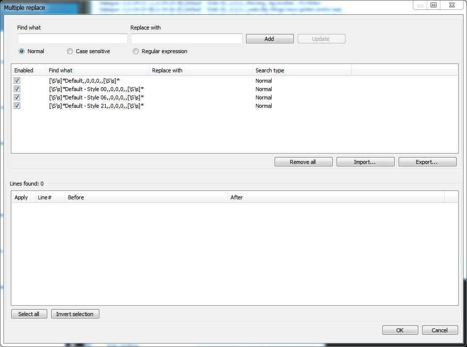

  1. Hey guys, I had few .mkv files with softsubs. They were displaying incorrectly in Splash Pro Ex. I looks like this (sorry for low-res). So I decided to extract the subs, delete the not-needed lines and everything should be ok. Easy task, right? Well, not really. I managed to extract the subs successfully and converted them to ANSI, so there comes the deleting. I didn't want to mark them one by one, of course. So I had to find a program with to do this. I downloaded Subtitle Edit and from what I read, this was supposed to delete everything between the * and [ Obviously I did something wrong. Can you guys help me edit these subtitles?

    The search type should be Regular expression for all those search strings.
  3. What regular expression exactly? I thought that what I have already is one. It was stated that
    Example 3: [\S\s]*addsite.org[\S\s]* + empty replace string -----> Will remove any subtitles containing "addsite.org"
    So I changed "addsite.org" with what had to be replaced.
    You should add the string([\S\s]....) and the empty and click on the Regular Expression checkbox and last Add.
    Then it should say Regular Expression in the Search type column.

  5. Ah, thanks! I will try this right now.
