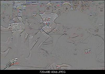

    Attached is what I get with this AviSynth script:
    ffVideoSource("source.mkv")
    AssumeTFF()
    QTGMC()
    encoded with the x264 command line encoder. No jerks, no flashes.
