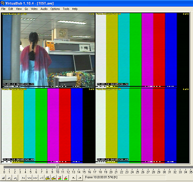

    Ok, that at least got us somewhere!
    That is not a "multiplexed" stream in the sense of discreet independent multiple views encapsulated within the one container file.
    Neither is that a quad-split overlay PIP type of multiplexed video.
    Rather, it is a time-sequential interleave type of multiplexed video (which only the security world even refer to as multiplexed).
    This is easily "de-multiplexed" by using a video processor (such as AVISynth script) that saves each 4th image to its own stream of the 4.
    However, I note that your file is corrupted and doesn't even follow its own pattern. Occasionally there is a loss of 1 or part of 1 frame. This will make extraction MUCH more difficult. Better to see why it is being created that way: is it a problem with interlacing? with frame-dropping? with HDD corruption? with a bad source file(s)? bad DV compression?
    Once that is figured out, and you have (again?) 4 separate video streams, you can re-process them to the way you'd like, such as a quad split. This is also easily doable in AVISynth.

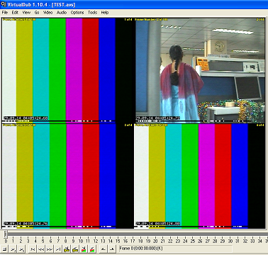

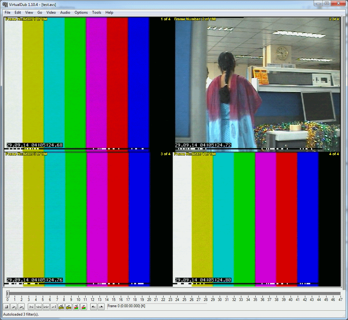

  16. Here's what Cornucopia suggested:
    1. Download and install Avisynth 2.6 from http://avisynth.nl/index.php/Main_Page
    2. create a FFMS2 folder inside your avisynth plugins folder (C:\Program Files (x86)\AviSynth 2.6\plugins)
    3. Download FFMS2 from https://github.com/FFMS/ffms2/releases and extract the content of the x86 folder and the FFMS2.avsi into the FFMS2 folder you created.
    4. create a text file and name it test.avs
    Inside the .avs file write the the following (and save the file):
    LoadCPlugin("C:\Program Files (x86)\AviSynth 2.6\plugins\FFMS2\ffms2.dll") # here you need to adjust the path to the ffms2.dll
    Import("C:\Program Files (x86)\AviSynth 2.6\plugins\FFMS2\FFMS2.avsi") # here you need to adjust the path to the FFMS2.avsi
    FFVideoSource("C:\Users\Selur\Desktop\UVS141~1.AVI")  # here you need to adjust the path to your input file
    bob() # deinterleces the video by bobbing
    selecteven() # throws out every odd field
    FFInfo(frametype = false, cfrtime = false, vfrtime = false) # shows the frame number inside the upper left corner
    v1 = SelectEvery(4,1).Subtitle("1 of 4", align=9) # shows that this is the first of every four frames inside the upper right corner
    v2 = SelectEvery(4,2).Subtitle("2 of 4", align=9) # shows that this is the second of every four frames inside the upper right corner
    v3 = SelectEvery(4,3).Subtitle("3 of 4", align=9) # shows that this is the third of every four frames inside the upper right corner
    v4 = SelectEvery(4,4).Subtitle("4 of 4", align=9) # shows that this is the fourth of every four frames inside the upper right corner
    return StackVertical(StackHorizontal(v1,v2), StackHorizontal(v3,v4)) # arranges the different views
    5. Download Virtual Dub 32bit version from (http://virtualdub.sourceforge.net/), extract it and open the test.avs file with it and you should see something like the image I attached.
    Scrolling through the frames in Virtual Dub one can clearly see that the interleaving of your streams isn't done consistently which is why the camera views change.
    Seeing that you are using a C++ development enviroment which is ment for embedded developing, this way to approach the problem is probably not what you are looking for. -> Your programmers might want to look into libav and ffmpegsource2.
    Cu Selur

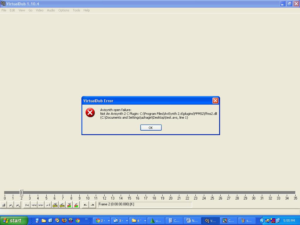

  17. i tried as per your guidance..
    i am getting the following error.. image i attached..
    * The problems which i faced during this downloading of this avi synth from the website u suggested. it shows the version name is 2.5, when i installed it shows 2.6 on the installation screen.
    The test.avs which i used is
    FFVideoSource("C:\Users\Selur\Desktop\UVS141~1.AVI ") # here you need to adjust the path to your input file
    and the pc which i am using is
    Microsoft Windows XP
    Version 2002 service pack 2
    What could be the problem?

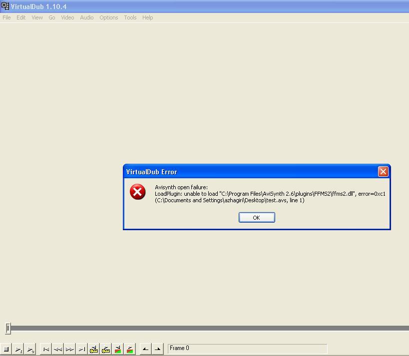

  18. Change 'LoadCPlugin' to 'LoadPlugin' (I'm using a modified version from http://forum.doom9.org/showthread.php?t=127037&page=49 which is a CPlugin)
  19. i changed from LoadcPlugin to loadplugin in the test.avs file. still i am getting avi synth open failure.
    .avs file i used
    LoadPlugin("C:\Program Files\AviSynth 2.6\plugins\FFMS2\ffms2.dll") # here you need to adjust the path to the ffms2.dll
    Import("C:\Program Files\AviSynth 2.6\plugins\FFMS2\FFMS2.avsi") # here you need to adjust the path to the FFMS2.avsi
    FFVideoSource("C:\Documents and Settings\azhagiri\Desktop\123.AVI") # here you need to adjust the path to your input file
    The error image i attached here.

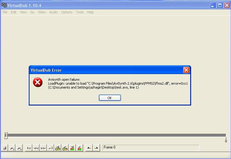

  20. Just use AVISource() instead of FFVideoSource()
    If you need a VFW DV decoder, install cedocida
    Instead of FFInfo(), use ShowFrameNumber()
  21. Just use i just replaced AVISource() instead of FFVideoSource() & ShowFrameNumber() Instead of FFInfo()
    Still the error is retains.
    .avs file is
    AVISource ("C:\Documents and Settings\azhagiri\Desktop\123.AVI") # here you need to adjust the path to your input file
    ShowFrameNumber (frametype = false, cfrtime = false, vfrtime = false) # shows the frame number inside the upper left corner
Name:	ERROR 0 XC1-1.JPG
  22. Take ffms2.dll out of the avisynth/plugins folder (e.g. move it into a subfolder)
    Do not use other arguments for Showframenumber() . (Don't use CFR time etc.... those are for FFInfo)
    This AVI sample has lots of errors, is that typical for this recording setup?

  24. i thank u for your guidance.. quad screen video is working.
    but the different video source is not displaying the same frame it is moving. example in a visual camera output display is moving like frame2,and some times frame4 etc.. the image i attached.. what could be the reason?
    The images i attached..
    if only 2 input we connect other 2 cameras are not connected means what will happen.. remaining 2 screen what could be the display status..

  25. what could be the reason?
    Cornucopia already wrote in https://forum.videohelp.com/threads/369705-avi-video-demultiplexing?p=2369858&viewfull=1#post2369858:
    -> The file doesn't follow a constant interleaving pattern and has corruption in it.
    Cornucopia already advised:
