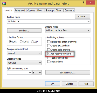

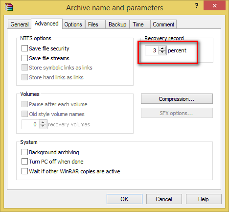

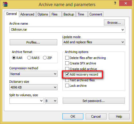

    If they do not provide checksum of the source you can not check if the file is downloaded without errors. But, depending on file type you can tell if file is downloaded with error. Installers won't run, archives won't extract files and music or video files will have artifacts or won't play at all.
    When you right click on file and choose Add to archive you will get a window with WinRAR compression options. One of those options is to enable recovery record. On second tab you can choose a size for recovery record.
    Recovery record uses advanced algorithm to scans whole file and generates additional data that can be used to recover any part of the RAR archive that is missing or it is damaged. Additional data is stored in the same archive.
    You don't need to split archive but you can if single archive becomes very large and can not be stored on chosen media (HDD with FAT32 partitions, USB drive, DVD disc ect). Recovery record works with single archive or multipart archive.

    This is useful for storing files as backup. For files in regular use this can be a problem as not much applications can read from archives. For those files using PAR2 recovery files is easier because recovery record is stored as separate file and original files stay as-is.

    Thank you very much for your explanation work. Just one more question - what does the size for recovery record mean? what is the number I should choose and what does they mean?

    The size is the amount of additional data. The higher the value, the larger the archive size on HDD, but the higher the probability that a damaged archive can be repaired or recovered
    5% means 5% additional size. Only you can determine how paranoid you are about data loss. People typically use around 5-10%
    A recovery record is NOT a backup solution. If things are important to you, make multiple copies and store them in multiple different locations
