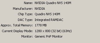

    Could this be to Notebook being underpowered or something else

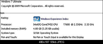

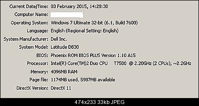

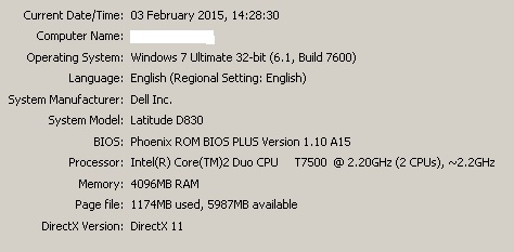

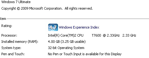

    Now i encoded the clip (using hello's technique) again on the M90 notebook, split a small section off where the video was bad.
    I have a different laptop for internet which is this one im using for this (Dell Latitude D830) like to keep things separate

    I thought i would test the clips on the D830, To my surprise, they play perfectly on this laptop without any artifacts using WMP and VLC. I even tryed the full clip and again no problems on the D830
    So the M90 can encode perfectly but has problems playing the clips (both in WMP and VLC) but the D830 can play (encoded M90) clips perfectly
    Could the M90 have a Hardware or Software fault as its more powerful than the D830
