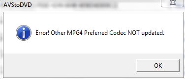

  9. Mr_C, Thanks for sticking with me on this. I appreciate it very much. I installed the LAV filters, but for some reason when I try to switch to the LAV filters in AVStoDVD it gives me a rather non-descript error "Error! Other MPG4 Preferred Codec NOT updated". I tried switching all of them to LAV instead of Microsoft and they all did the same thing.

    Try using Win7DSFilterTweaker.
    _MrC_ Microsoft DTV-DVD decoders have cause me issues in the past including sync issues, and they are stubborn about giving up their preferred status.
  11. I made sure I ran the program with admin privileges. Is there anything else I can try to get them to switch over ?
  12. Running the exe with Admin privilege is not enough. You have to be logged as Admin of your machine.
    BTW ff the built-in function of AVStoDVD does not works, you may use Win7DSFilterTweaker as suggested by gonca
