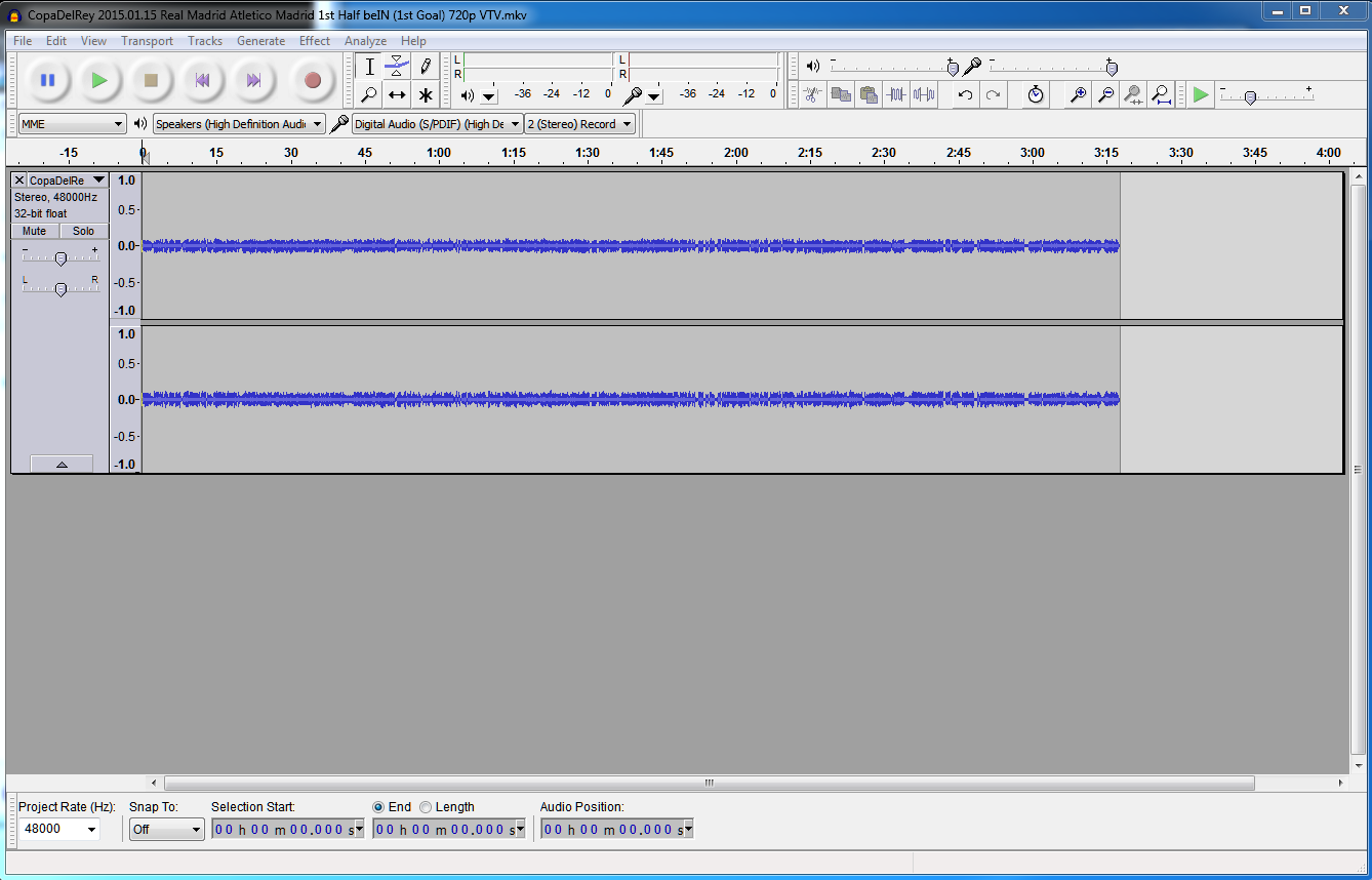

    Hi Cornucopia, thanks.
    This is the audio file, what do I do?

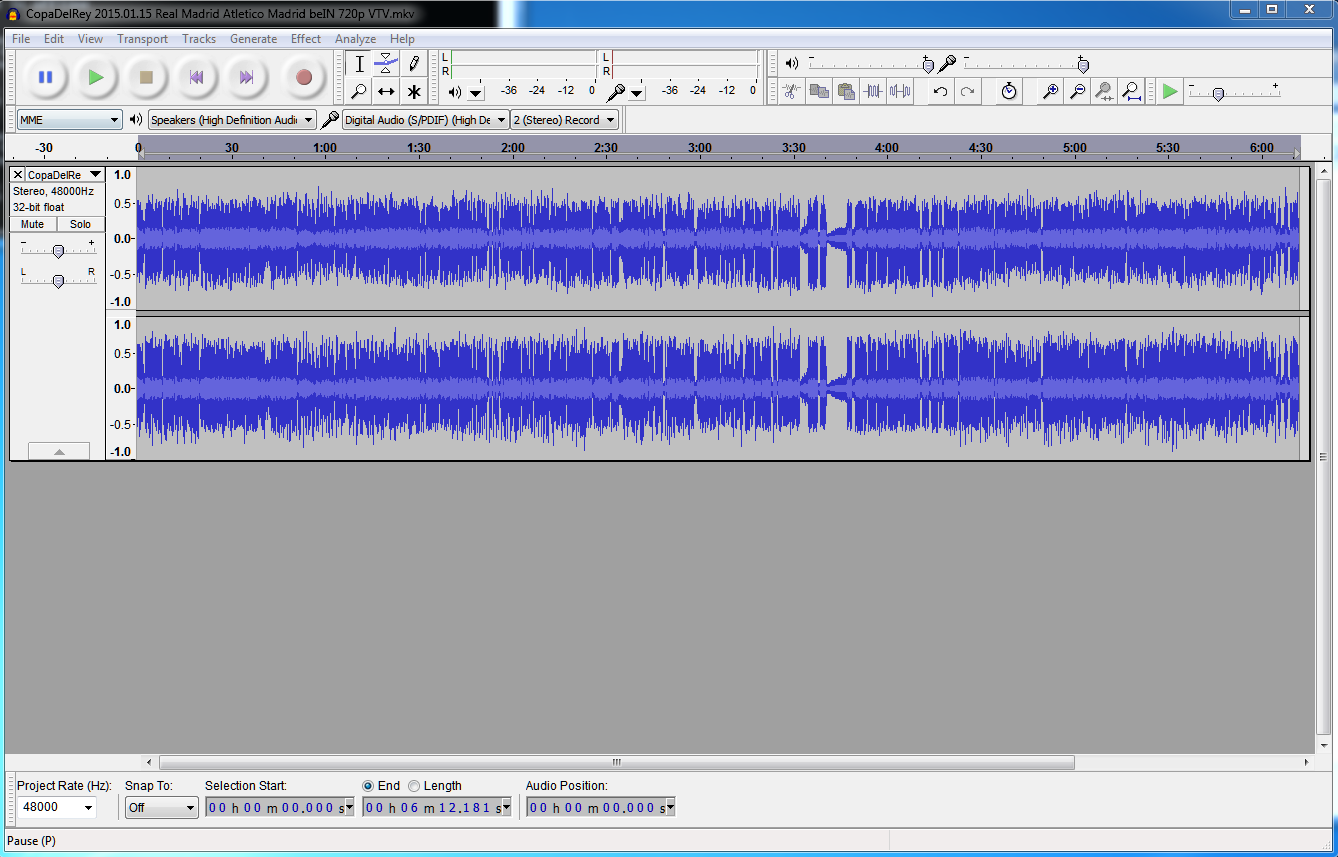

    Bingo videobruger, you are great!
    Using the "Normalize filter" default option, I got great volume now.
    Thank you!
