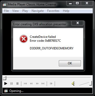

    @skaleton
    I installed and ran the 32bit MPC-HC and got the folllowing error message on all video types. Click OK and the file plays fine. There's no problems with the X64 version. Is this error you're receiving? I suspect it's because I'm running X64 DirectX.
