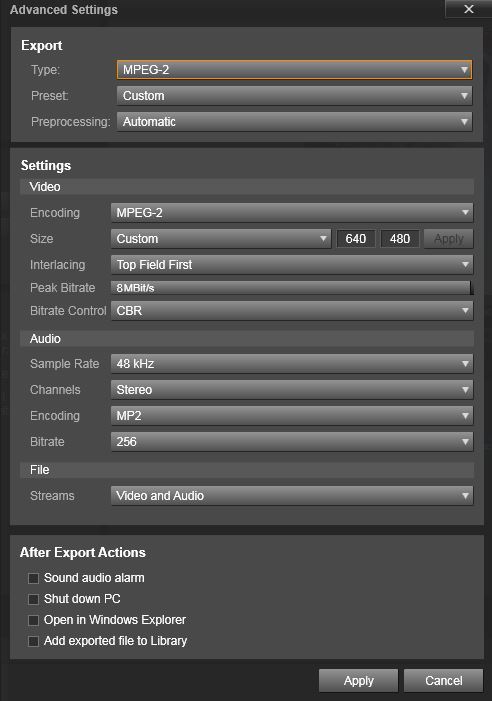

    On a related topic, I've tried the MPEG-2 vs. MPEG-4 experiment using SD footage (source files are Sony DV AVI) and I noticed that the MPEG-2 was out of focus for the 1 minute clip whereas the MPEG-4 has a lot of artifacts and just looked awful. The footage was shot outdoors in well lit conditions. I don't understand why the MPEG-2 had focus issues. Neither had automatic adjustment enabled. My settings for the MPEG-2 (via the advanced menu) were as follows:

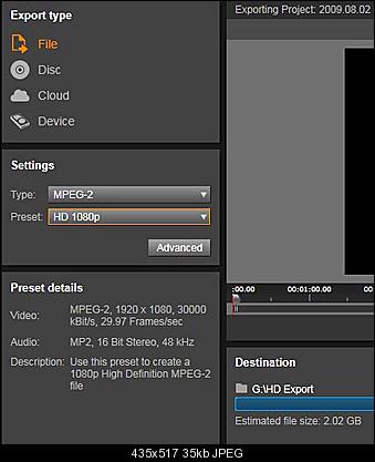

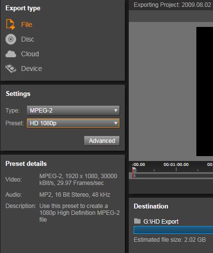

  4. Also rather interesting and unexpected...the HD MPEG-2 files that looked fantastic on the TV are actually larger in size than my source files. For an ~8 min video clip the combined file sizes of the .m2ts files is about 1.5 GB whereas the exported MPEG4 output file is 2.1 GB. Is this Pinnacle Preset (see below) overkill? Any suggestions to customize? I want my exported file to be no larger than all of the source file clips combined.

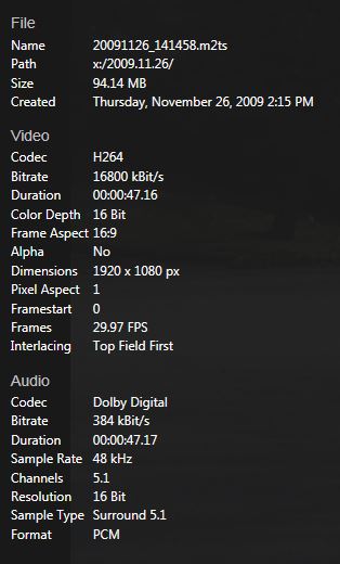

  5. Should I be using export settings as close to my source settings as possible?
    My source settings are:

    2) Disk space is not an issue HOWEVER exported footage IMHO should NEVER exceed my source footage for the simple reason that it is shorter due to the video editing process. The only reason I realized it was exceeding it was because the bit rate selected by the Pinnacle 18 export preset "HD1080p" was 30000 kb/s and my source footage was only encoded at 16800 kb/s.....so that seems to be the reason why the files were larger than I expected.
    3) Last night while I was continuing the HD footage experiment I produced very good MPEG-4 quality once I changed Pinnacle's default MPEG-4 encoder from MPEG to H264 AND tweaked all of the advanced settings to match the original footage from my Panasonic HD camcorder (H264, 16800 kb/s, top field first, etc). The MPEG-4 actually looked better than the MPEG-2, especially during panning and recording non-stationary objects. So I think I have the solution for my HD footage at least.
