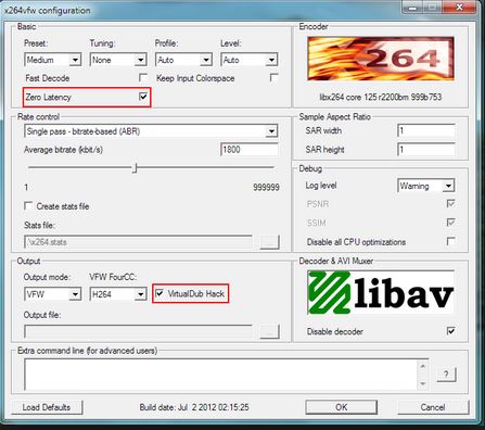

  7. Hi, I probably asked the question bad, sorry I'm a newby!I mean, through Camstudio I can get a window like the one in attachment and there I can configure the X264vfw and the editing I do there works for other programs as well, but on Camstudio there isn't an option to set up the regular X264 codec and some programs where I use x264 don't allow me to edit it, so is there a tool where can I get a window like that for X.264 to set it up for other programs?thanks so much
  8. You can use the Extra Command Line box to pass parameters to x264. Enter command there just like you would with the command line version of x264. Those options are added after the preset so you can use them to override individual preset settings.

  10. I told you there is a build of x264vfw that a configuration dialog that included many of the individual x264 settings. You just need to find, download, and install it. Then you'll complain that it doesn't have presets.
    This post has an image of one page of that more complex dialog:
    https://forum.videohelp.com/threads/363198-x264vfw-configuration-in-VirtualDub-please-h...=1#post2309548
