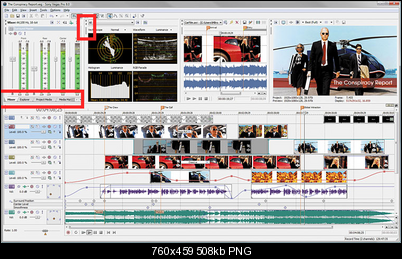

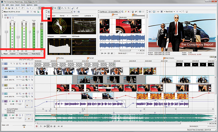

  2. You should be able to open multiple windows using the tabs, resizing, and tear-off controls.

    Vegas 8 is very old though and 32 bit. It may be easier and faster in newer 64-bit versions.

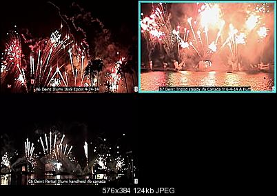

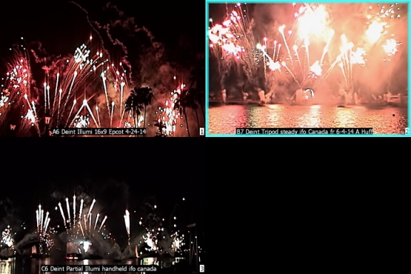

    I'm not sure we're talking about the same thing. Instead of working from multiple tracks, Vegas creates a single multicam track out of several which creates a multi-view in the preview window. Which as far as I can tell precludes viewing any transitions as you would normally do.
