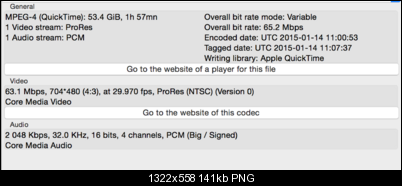

  7. Thank you for your response, really appreciate your help. I have used MediaInfo and the result is as follows:
Name:	Screen Shot 2015-01-14 at 5.38.06 AM.png
    Does this mean it is saving as mpeg?
  8. Since you're sending a DV stream you should capture DV. IIRC, QTX will not do this, so it transcodes to ProRes (which is what you have.) Use the latest QT 7.x instead. That being said, as Scott mentioned, DV is DV whether raw DV, DV-avi or DV-mov. Just slightly different packages, quality should be identical.
