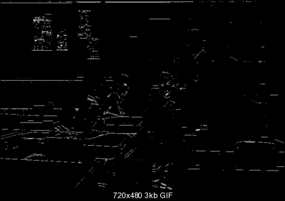

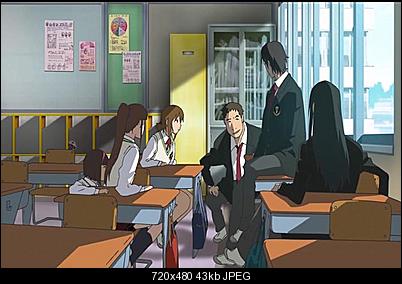

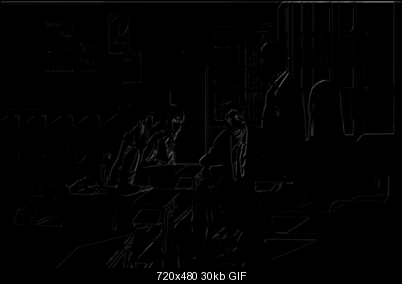

    Nope, tried 1.5.7 and got same old binary mask... Here's screenshots:
    original
    combmask(thy1=0, thy2=255)
    edgemask(thy1=0, thy2=255)
