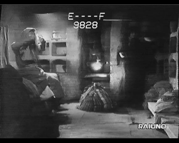

    The video has flagging at the edge, and, also, the image can't stay still, and it's like the objects shake fast and continuously from left to right and back.
    Here's a gif as sample:
    When I use the Easy cap to capture video directly from camcorder (like a webcam), everything is just fine.

    A little difficult to tell with just a gif but in my eyes this looks more like a weak signal than time base errors.
    Could be down to worn heads, poor tape quality etc. etc.
    And is this meant to be B&W ?

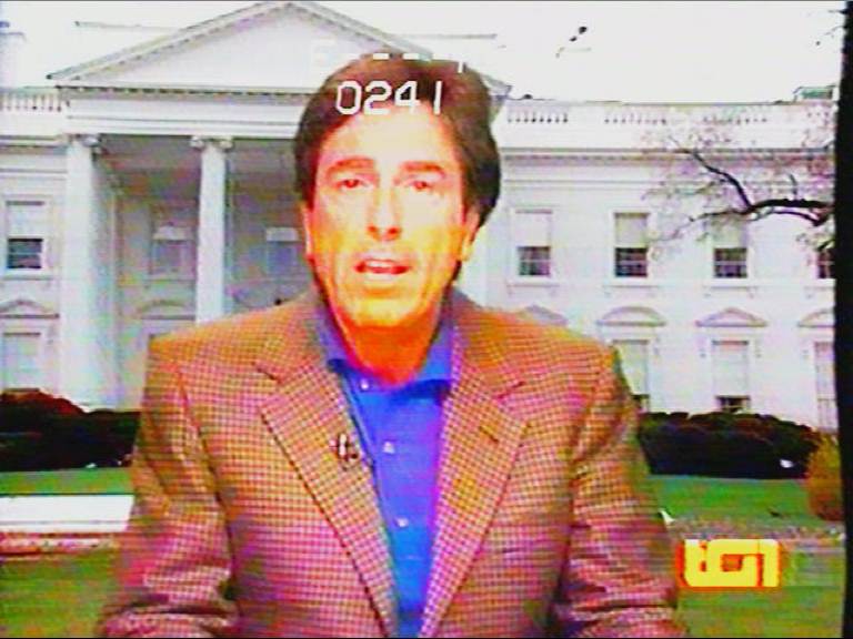

    And, as you said, actually it was colored, here's a picture:
Name:	Senza titolo 1.jpg
    Please, note that the bended edge is only while capturing.
    How can I check if it is a weak signal problem (and save bucks)?

    Well that colour screen is very weak. Hardly 'perfect'.
    So someone records the tv to a tape and then does a vcr to vcr copy without any signal enchancement. Result is poor video. A TBC will not improve on that.
    A video enhancer/booster might help. But the real damage is already done.

    Your first sample was from Rai Uno. I asked if that was meant to be in colour (I suspect not but it was necessary to ask). But you then provide another sample in colour. Are these on the same tape ?
