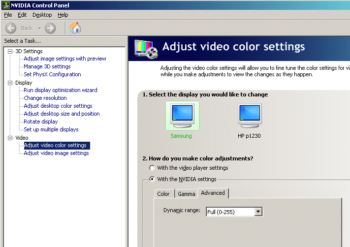

    Most video cards have a setting to expand the levels for video so it doesn't require the player to get it right. For Nvidia it looks something like this. It shouldn't matter if a player and the video card drivers are both set to expand the levels. They won't be expanded twice.

    I suspect maybe you're used to VLC being brighter, but it's not really "correct", but all of the above assumes you're viewing the video with a PC monitor and not with a PC connected to a TV. If you're connected to a TV then expanding the levels might be the wrong thing to do as it might expect limited levels and the picture would then be too dark.
    To add to the fun, if you expand the levels using the video card drivers, they kind of "take over" and MPC-HC's own brightness and contrast controls etc will probably stop working. If you then want to adjust the brightness or contrast etc, you'll probably need to do it via the video card's settings.
