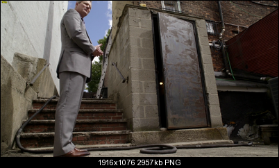

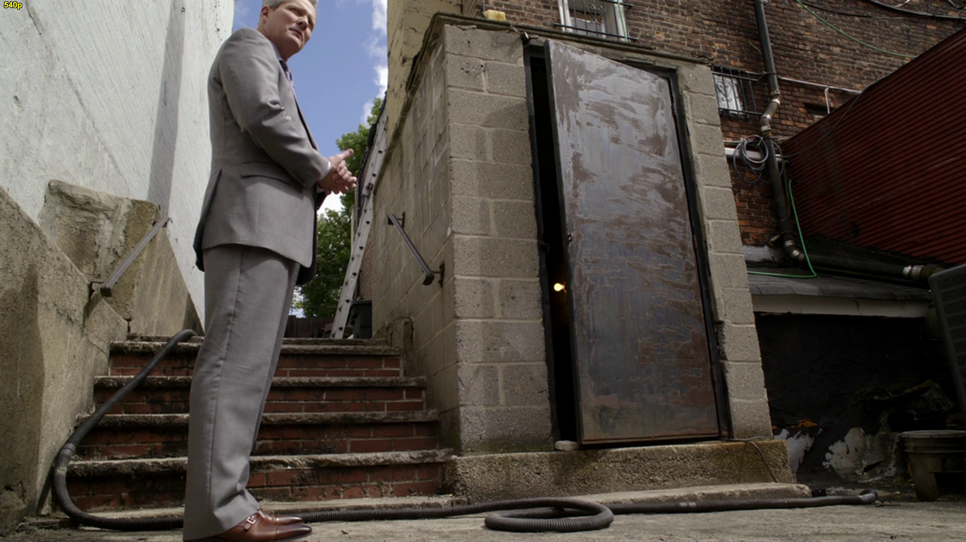

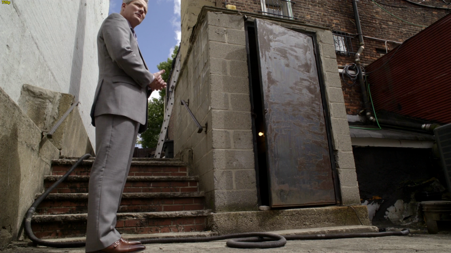

  6. I had a bit of a play with some resizing comparisons via the script below today. The source video was 1080p. I opened the script with MPC-HC and ran it fullscreen on my TV (51" Plasma). Because the source is 1080p, the player isn't doing any resizing.
    ClipA = Last
    Original_Width = ClipA.Width
    Original_Height = ClipA.Height
    ClipB = ClipA.Spline36Resize(1280,720).Spline36Resize(Orig inal_Width,Original_Height)
    ClipC = ClipA.Spline36Resize(960,540).Spline36Resize(Origi nal_Width,Original_Height)
    Clip1 = ClipA.Subtitle("1080p")
    Clip2 = ClipB.Subtitle("720p")
    Clip3 = ClipC.Subtitle("540p")
    Interleave(Clip1,Clip2,Clip3)
    For those not overly familiar with AVIsynth, the script displays a frame of the original 1080p video, followed by the same frame resized down to 720p and back to 1080p again, followed by the same frame resized to 960x540 and back. It still surprised me how often I couldn't see any loss of detail, even when the video was downscaled to 540p. Mostly, I'd need to look for frames with objects with nicely defined edges, as sometime the edges would look a little blurred after downscaling, but there still wasn't always a massive difference. I'm not saying this is typical (I've definitely seen 1080p video with more fine picture detail), but maybe it's also an indication as to how good Spline resizing is.....
    This was one of the few scenes with enough detail or sharp edges for the effect of the resizing to become fairly obvious, but that's comparing individual frames close up. I doubt I could pick 1080p from 540p back at normal viewing distance. The screenshots are about 3MB each as they're lossless.
    1080p
    720p upscaled
    540p upscaled
    Edit: I just realised the original video isn't exactly 1080p, it's 1916x1076. Not that it matters. The script is resizing to 720p/540p and back to the original resolution, so the result doesn't change.
    I modified the script so a softer resizer was used for upscaling. I'd be willing to bet most players use sharper upscaling, so it's probably "worse case scenario" upscaling in respect to sharpness. The difference between the resolutions is a little more pronounced, but 960x540 still isn't all that bad.
    Not that my experiment really proved much. I just thought I'd share.....
