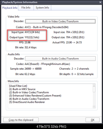

    Someone explains me what is the difference b/w YV12 and AVC1 and which one is Better ? is AVC1 Better?? is this Affect Video Quality??

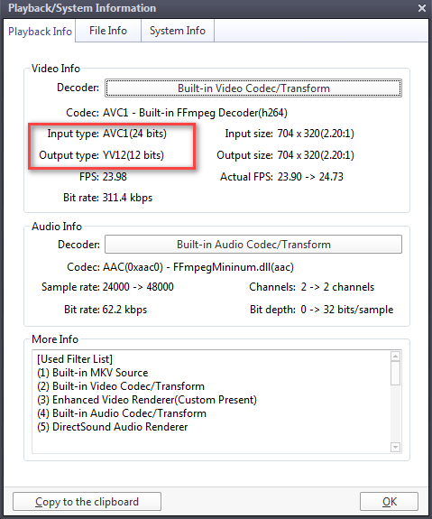

    i 'm using PotPlayer , i played an Movie , i Check the info and in Info it says "input Type AVC1 (24bit) , Output Type YV12(12bit)
  2. Member Cornucopia's Avatar
    AVC1 is the fourcc for the compressed codec AVC/h.264/MPEG4part10. AVC can be Y'CbCr 4:2:2 or Y'CbCr 4:2:0 (most common).
    YV12 is the fourcc for the uncompressed, or DE-compressed, stream. By definition it is Y'CbCr 4:2:0.
    All that screen is telling you is that it is taking a compressed signal and decompressing it for playback, which is what ALL players have to do if you expect to be able to see it.
    YV12 is decompressed, and by nature that ought to be better, but it's only better if it were always uncompressed, and NOT, as is the case here and most commonly in players, where it is decompressing the compressed stream. Then, the quality is the SAME. The data stream is much larger being decompressed. But again, that is necessary if you expect to get something that is viewable & recognizable to humans.
