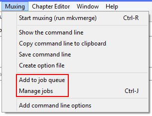

    Edit: Can you not achieve this with mkvmergeGUI? Add files, un-check needed streams, then under the Muxing menu use "Add to job queue", then "Manage jobs" and Start?

    In that case, surely it's worth avoiding scripting and trying the aforementioned batch processing in mkvmergeGUI.

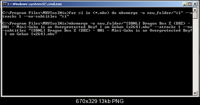

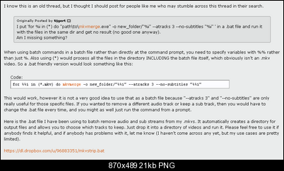

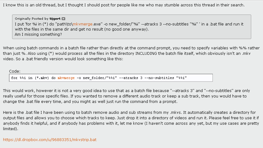

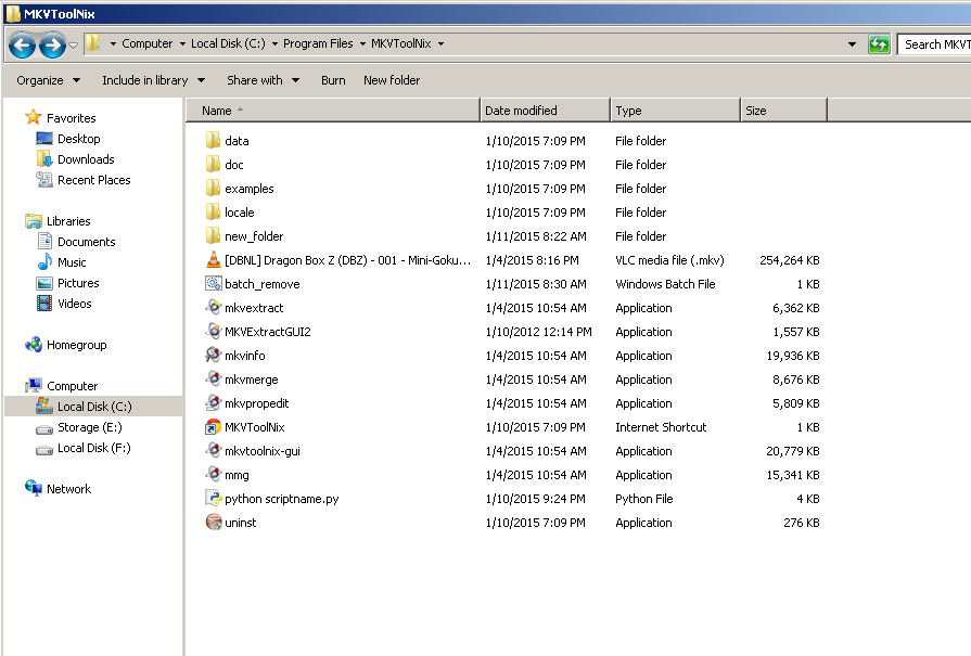

    Here is where I am at... I tried my hand at making a batch file from a post in the thread you linked. I made it in the directory of mkvmerge and running it but nothing happens. I have a copy of the .mkv I am trying to fix in the same folder along with the batch and the .exe's but it doesn't do anything but quickly flash this screen when I run it...

  8. I also tried downloading Patrick's bat file and running it in the same folder and it doesn't create anything new at all... man this is stumping me pretty good.

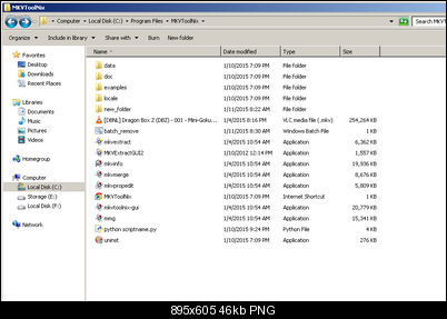

  9. Success! I finally did it!
    Here is what I did and it finally worked. I pulled the MKVmerge.exe out if its directory and put it into a new folder. I then put the .mkv I wanted into the new folder as well. I then dragged and dropped the two batch files I had been trying out to the new folder. Clicked the batch files and it successfully removed the audio track and subtitle track I wanted, I then tried with multiple files and it worked like a charm.
    I'm so happy right now

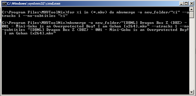

    This is the batch command I used and it worked perfectly.
    for %%i in (*.mkv) do mkvmerge -o new_folder/"%%i" --atracks 2 --no-subtitles "%%i"
