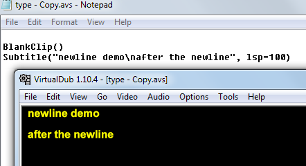

  5. Originally Posted by smike View Post
    It doesn't change anything. I tried setting it to 1, 10, even 100. The last part is still cut off.
    Works for me:
    I made a mistake though. If I leave out lsp entirely I get no line break (the \n is printed). But explicitly setting it to any value, even zero, gives the line break. I'm running AviSynth 2.6.
    Ah, I see. The second line is being printed off screen with align=2.
