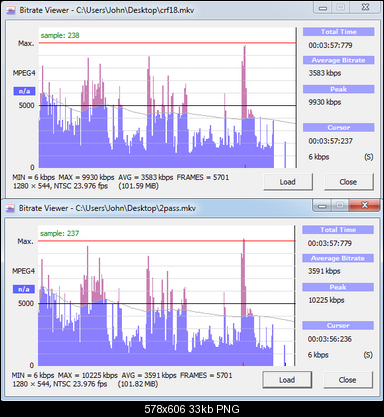

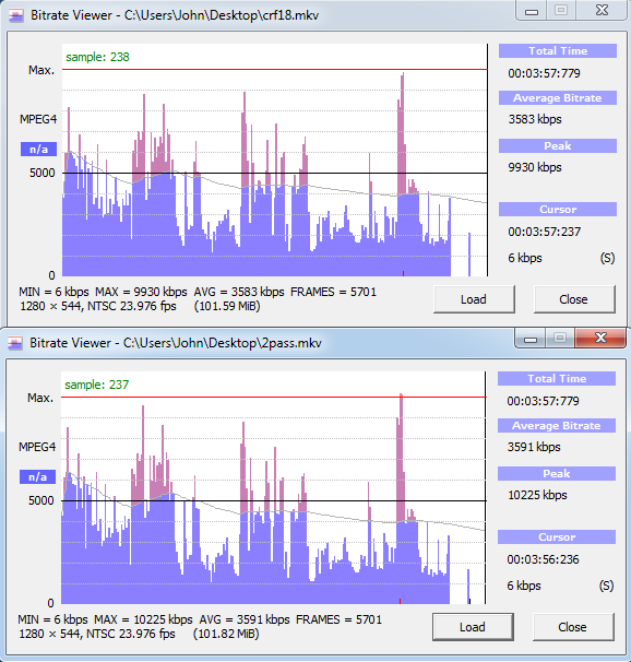

  25. I'd like to know using 2pass, what bitrate to choose for video to be more efficient as oppose to 1pass CRF.
    Since 2pas and 1pass crf use the same rate control in the backend and thus produce near identical output for the same output size this doesn't make sense.
    Use 2pass if you aim for a specific file size, otherwise use crf with a value that retains as much details as you want.
    What'ss the trick
    No trick two methods do reach different goals.
    I think your point of view is "bucket" oriented, where you have bitrate as a given and than you tend to analyze things, but today there is no need to encode to size , only to be efficient and bang, dang, done.
    The problem is always the definition of 'efficient' and/or 'quality', but that aside if you don't aim for a specific file size or bit rate crf is the way to go with x264.

  28. A CRF encode and a 2-pass encode in x264, slow preset, CRF=18, bitrate=3580:
    As you can see the bitrate distribution is substantially similar. The videos themselves are substantially similar too.
