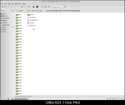

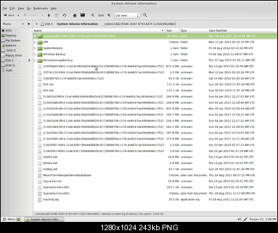

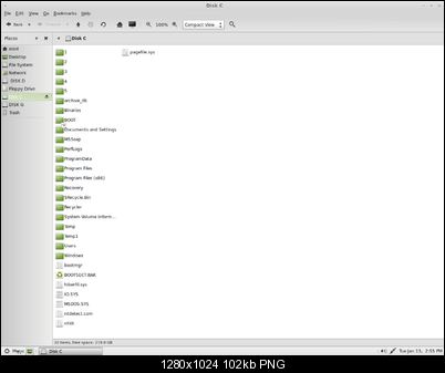

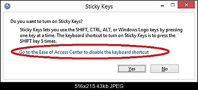

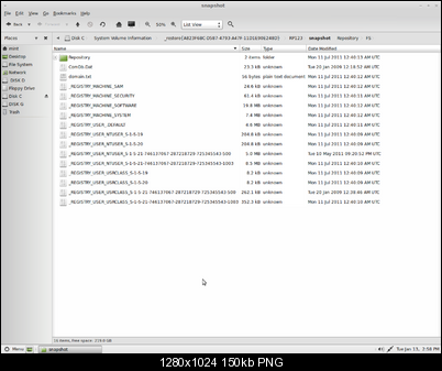

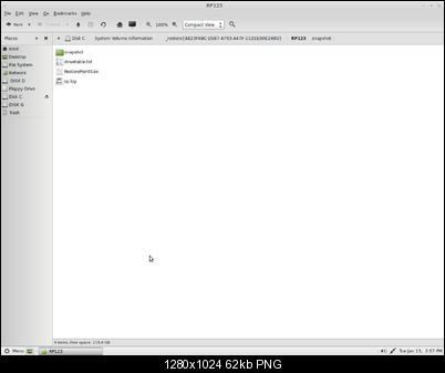

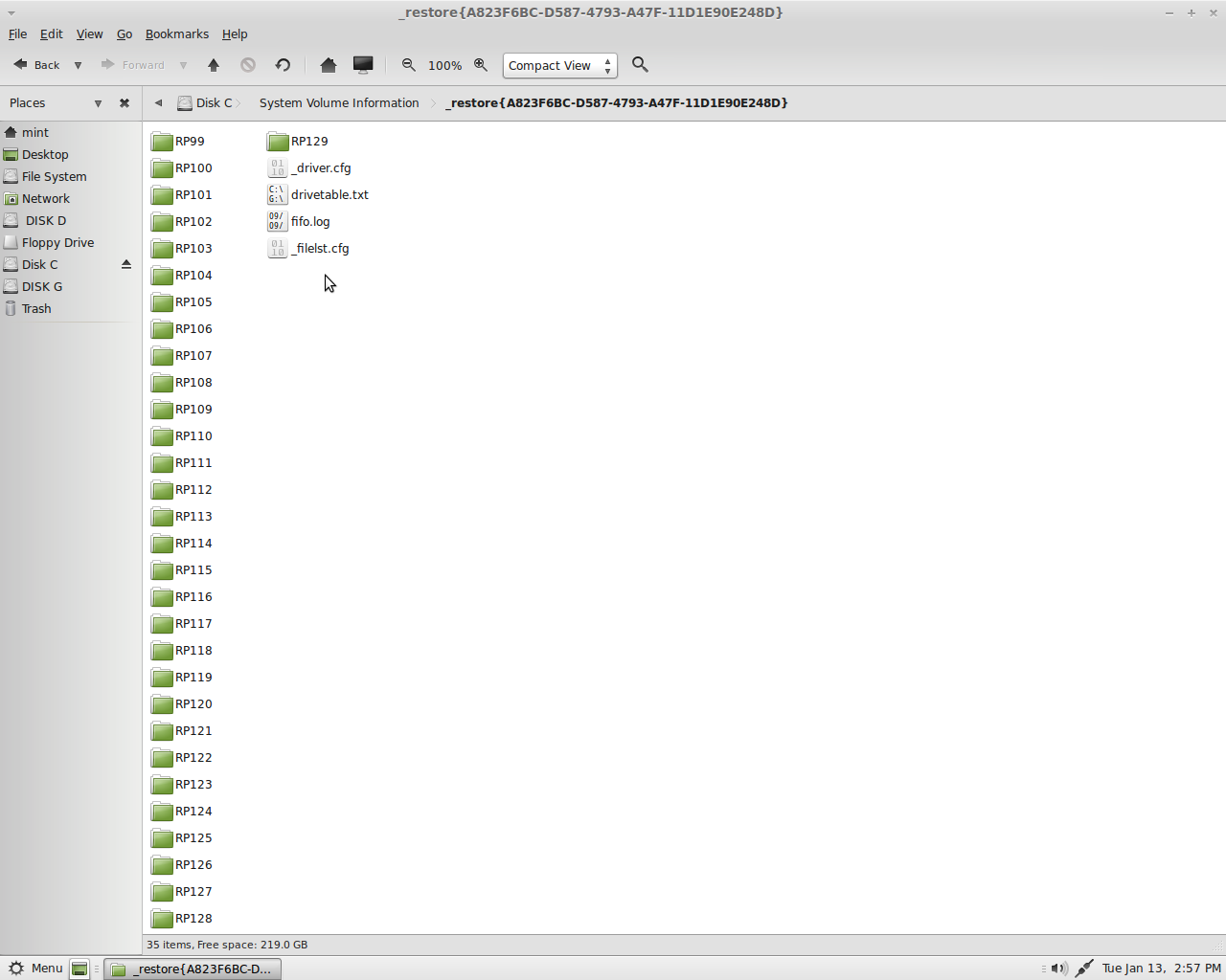

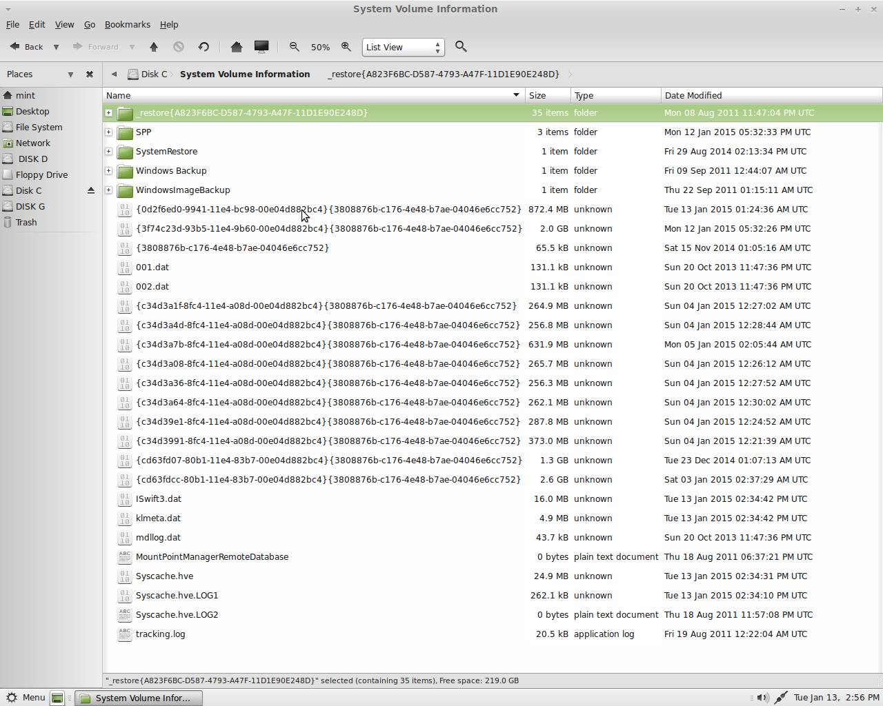

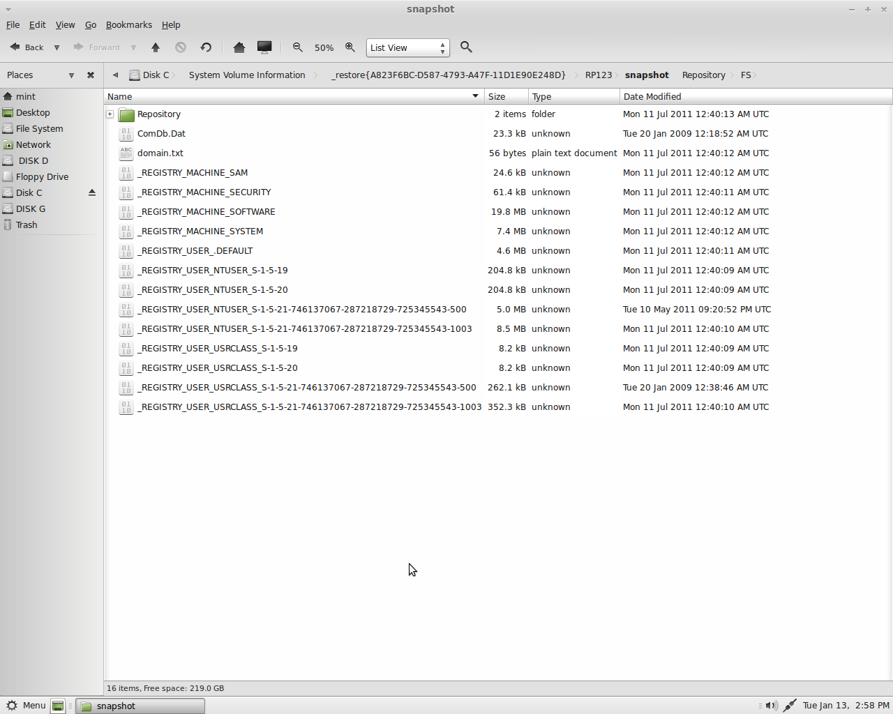

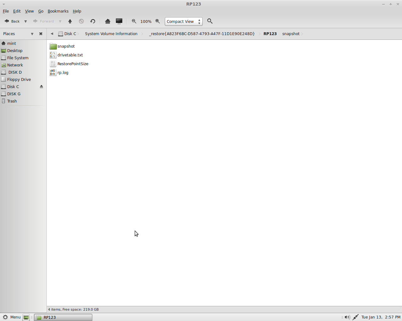

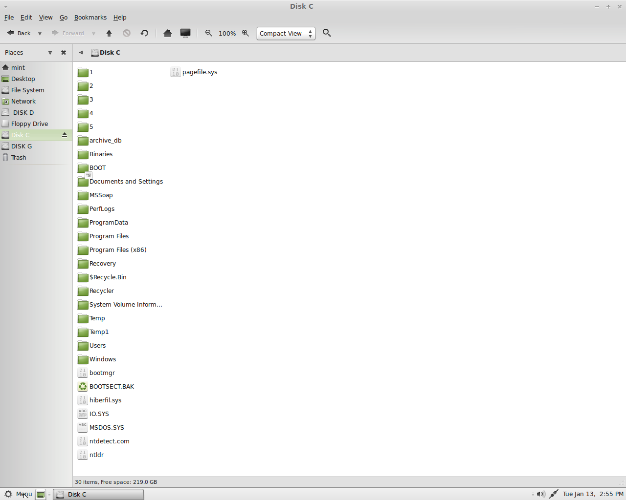

    This is what's in my Win 7 x64 system volume information folder. I'm using a Mint live disc to view the folder so I know I'm looking at files and there's none of that NTFS symbolic links or virtual folder shenanigan going on.
    Looking at your screen grab, those "huge files" are listed as local discs not as files or folders, can you see what's the file extension? Is this something that Paragon did when it backed up the SVI or is it a symlink magic trick? Could you restore the image to a spare drive and use Linux to look at the files?

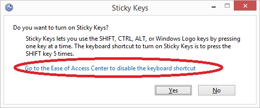

    Nooooooo, not sticky keys! I spent hours trying to fix a laptop once that turned out to be bloody stinky keys got auto-enabled without anyone noticing it. It would load up to the login screen and seemingly freeze there as typing a password wouldn't register any keystroke, funny thing the login screen had a black background. The only time I'd ever had to deal with it was when a client would complain that his PC said it had sticky keys and he wanted me to clean his keyboard! That's such a useless app, does any body use it other than Parkinson's patients. There doesn't seem to be any way to disable it in Win 7.
  13. Yeah... files and hives from 2011. Very useful.
    They don't have an extension.
    Paragon? What makes you think I use that malfunctioning piece of shit that almost destroyed my system in 2012?
    I used it just now to change the drive letters to reflect their PROPER designation and now this spare partition is damaged with Windows MSI errors, so I have to reinstall it now. Thanks Paragon.
    I don't know what you mean by looking at the files with Linux. Can it OPEN them and extract anything from them? Your question sounds like "are they actual files?" Yes they are.

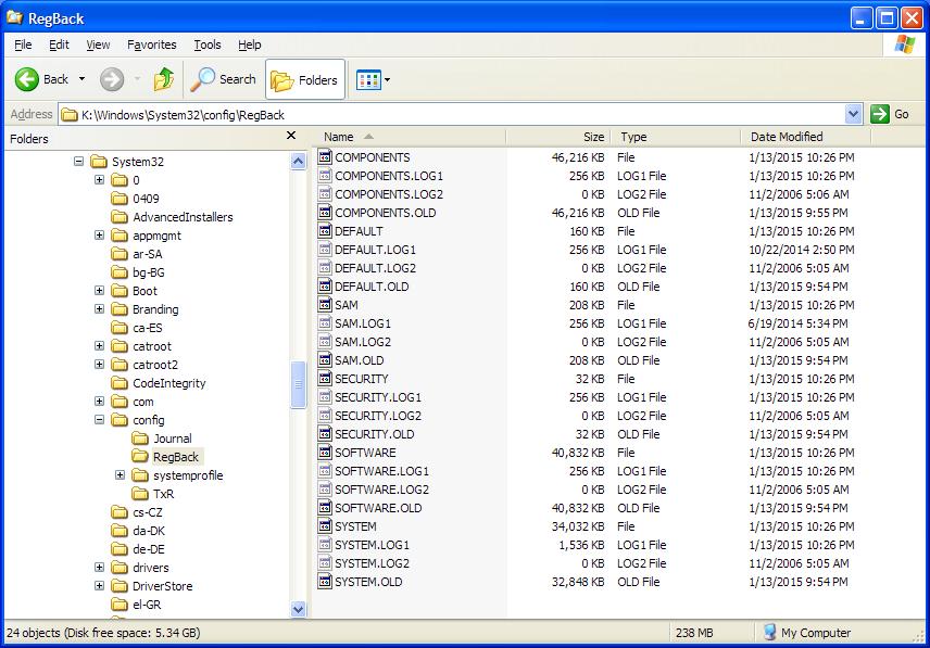

    Perhaps there was an underlying problem with your system, the \regback folder is supposed to contain recent backups.
    For example, here is the contents of my Vista system.

  24. Did everything, I get this:
    Why can't I just open the individual fückin huge gibberish files? I had to spend hours converting the entire damn partition image to a VHD and in the end I get an error with no explanation.
    And guess where I have been the past few days? I tried to create a new partition on the free space on my 2TB HDD with microsoft's diskmgmt.msc because I was too lazy to install EaseUS partition manager but as soon as that happened a few of my partitions went missing so I deleted that new partition I created a few seconds ago fearing I might've created it over one of them and... that somehow deleted all partitions (including this spare Win7 installation) on my 2TB disk. It was 2012 all over again, I spent 16 hours recovering all of my partitions, two of which were backups of my damaged C drive and so far I've recovered 7/8 of them. Does ANY part of this piece of shit operating system not malfunction?
  25. Total stab in the dark here, but found this in another forum. I see from an earlier post that from your black screen you can repeatedly press shift and get the sticky keys dialog to show up.
    Not sure if you will see the highlighted link as some users in the other forum said they couldn't. If you can't see it the rest of this post will be pointless so feel free to stop reading!
    1) press shift several times until the sticky keys window appears
    2) click the link that'll lead to ease of access center
    3) click cancel on the the bottom right corner of the set up sticky keys window
    4) click control panel on the upper left corner (beside the make your computer easier to use title)
    If this works you will at least be able to get your control panel up and access the system restore/recovery section. Don't know if you can resume an interrupted system restore or restart it again from scratch, assuming the files you need to restore from aren't completely borked. With any luck Windows will recognise that something went wrong with the previous attempt and offer you some options to resolve it (although I wouldn't risk anything valuable betting on it knowing Windows!)
    The remaining points below are what the original poster in the other forum did, but may not be relevent to what you need to do next.
    5) on the computer settings menu choose the recovery icon (make sure that the view is by either large or small icons for easier access)
    6) click open system restore
    7) click next on the bottom right corner until the button finish appears, then click it. (just follow everything the window says that will lead you to recovering your previous system in a certain time)
    8) let it do its job and wait until your computer restarts
    Best of luck finding a solution if this turns out to be useless.

  26. Originally Posted by Mephesto View Post
    'Cause MS doesn't spend much time polishing admin tools of that sort. Your first try applied to the shadow copy in the C drive SVI that should have worked, that can only mean the program has a bug, this patch should fix it.
    Yeah, I wouldn't trust that buggy app for anything than the most basic tasks. The only disk management software MS ever put out that worked right was Fdisk, disk management in NT has been screwed since Win2k. I use Gparted for all partition work, never failed me yet. OTH, I'd never re-partition a live drive, don't you have an old drive or even a large enough flash drive lying around.
  27. Thanks for the link to the hotfix. I was able to mount this time but now I have:
    Sigh... you don't suppose there's a way to do a chkdsk on this do you? It mounts as a symbolic link and not as a local disk/removable drive.
    I needed a partition to copy this VHD to as you instructed and I considered creating one on the 260GB of free space left on this 2TB drive a simple operation. 'Guess I was wrong. This is the first and last time I ever use disk management. No I don't have a 250GB flash drive and this 2TB drive IS the old drive. My SSD is my main drive which as you know hosts my blackscreened OS.
  28. It's supposed to mount as a symlink, you can only hope the corruption happened during the conversion process. Do you have a PC shop nearby that sells off-lease and used hardware? A 320GB drive usually goes for less than $30. You should try to restore the PBD file to make sure it's useable and while you're there you could just access it's SVI directly.
  29. I can already access the SVI directly, of both the PBD and the new VHD that I mounted as an actual drive from which I mounted one of its restore points as that symlink you talked about which it said was... corrupted. Can I mount the restore point as a drive instead of a symlink?
  30. When you attach the VHD with diskpart a new drive should be created. Don't mark it as read only and you will be able to change permissions... but you may also get unexpected changes as in I have no idea how Windows is going to react to the new SVI. Not that it would be bad, you can always convert the PDB to VHD again. You could try Shadow Explorer on that drive, but it might be that the only way to access the content of the Shadow Volume is with a symlink.
