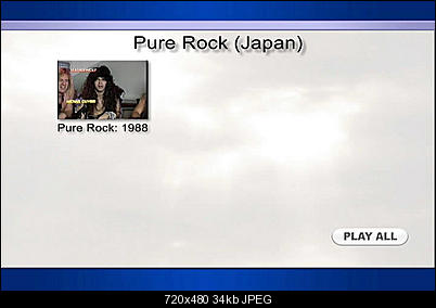

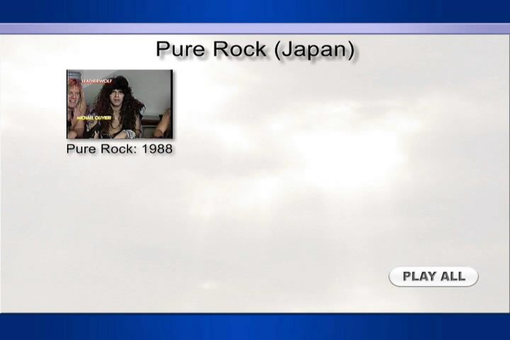

    I already did one of the discs with Nero Vision, and I was not happy at all with the quality. I didn't bother even making a menu for it, but when compared to the original disc, it don't look as good. I just did the one disc with Nero Vision so I could actually watch it on my TV.

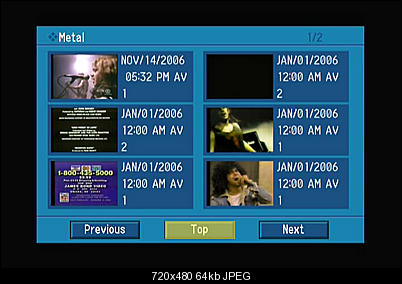

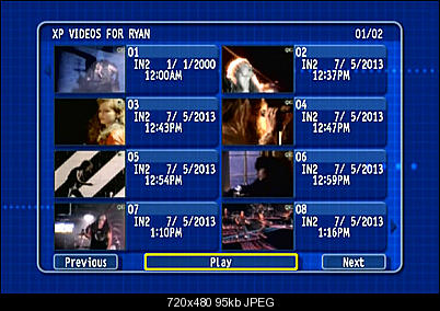

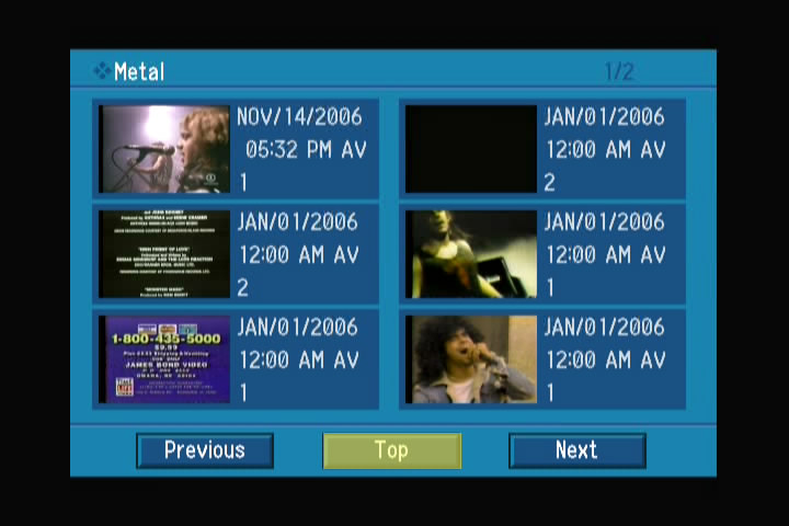

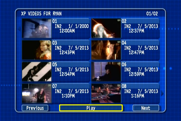

    I just tried this TMPGEnc Authoring Works 5 trial out, and it copied one of the VR discs in no time it seems.
    I guess I'm going to lose the menus regardless, but does anyone have any idea where I could somehow duplicate one of my standard DVD Recorder menus from one of my other DVD's? I have so many of them, but there are a few I prefer.
    I didn't see any menus that I even remotely liked on the template. I just want something that looks like the old standard DVD Recorder menus. I even have some regular DVD-R's that have Japanese DVD Recorder menus, of course those are in Japanese but they are better (in my opinion) than these computer created menus.
    Something like this (above) would be great.
  15. Luckily the TMPGEnc method seems to be working for you: now you just need a disc menu template that mimics the typical bare-bones recorder design. It should be possible to find one posted somewhere, or tips how to create one yourself, if you comb thru enough threads re TMPGEnc, DVDStyler, etc. The great advantage of doing this job on a PC is you aren't held hostage by a cantankerous unsupported old recorder that could die on you at any moment.
    IDK if it will relieve you to know this, AnthraxFan1987, but the odds of you actually finding a fully functional Toshiba DVD/HDD recorder compatible with your old VR discs were between zero and nada anyway. Those models have not been made since 2006, and their dvd drives were notoriously fragile (prone to errors then death before the warranty was even up). They were amazingly versatile machines, and might indeed have been able to do those conversions for you by ripping DVD-VR > HDD >DVD-R Video Mode (I remember this topic coming up on very old Toshiba threads: they had remarkable re-authoring capabilities, and my own Pioneer brand recorders can do a similar VR>HDD>DVD Video trick, retaining chapters and title names). But the hopelessly crappy Toshiba dvd drives would have derailed you: most surviving Toshibas were long ago retrofitted with quasi-compatible generic PC drives (also failing now). Getting those third-party burners to work in a Toshiba was tricky, and always involved significant loss of dvd functionality (flexible ripping options being the first to go).
    Good luck with your project.

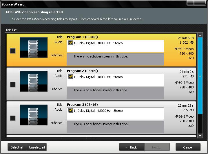

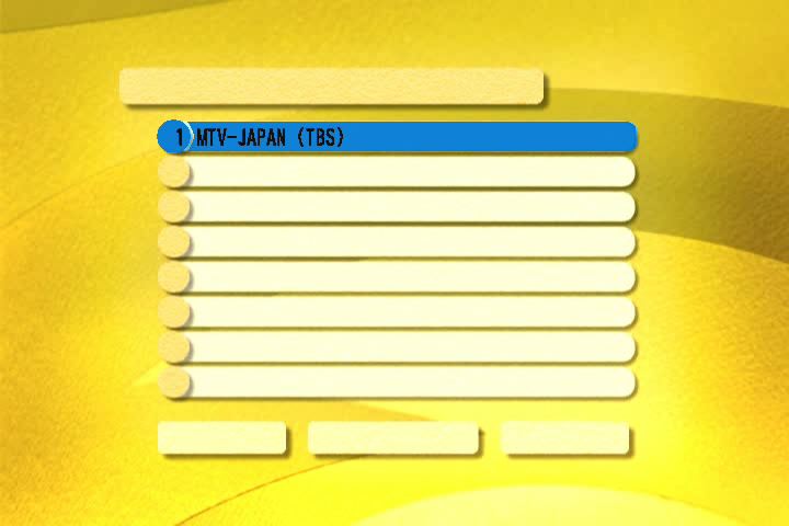

    I have another question. I came across 3 DVD's that will not open in TMPGEnc, and I can't watch these at all! Yet my friend sent me these for nothing in a trade. One is called 'Metal Fire', one is a more recent 'Rock City' DVD, and the other is a Headbangers Ball Japan DVD from late 2013, they are all in 16:9 Widescreen (or so it says on the information).
    When I try to copy them, I get this error that says 'This Title Is Protected, You Cannot Select It'.
    Granted these are the only 3 discs that I own with this protection problem on them, I have never seen them actually play before either.
    I added some screen-grabs so you can see what I'm talking about:

    My question is: Is there a way past this? Or are these 3 discs hopeless? There are supposed to be some good videos and interviews on them, but I've only seen them listed on his list.

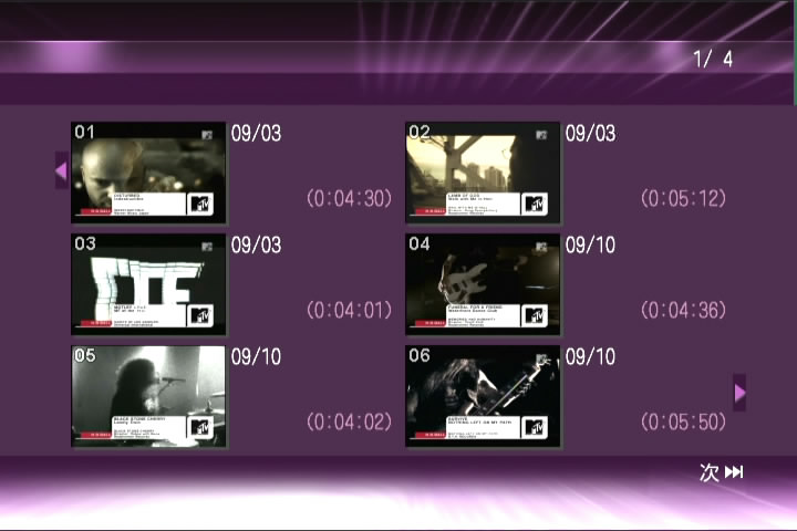

    The menus were different, I know the Toshiba discs (the difference between those from what I can tell, they all say 'TSB0003' when in the drive) had a different menu from what the other discs had. The 2 discs that were titled 'TSB0003' had the same exact menus, but the others had slightly different menus, which looked similar to Samsung DVD Recorder menus. They were all in Japanese too, so I seriously doubt they were 'Faux Menus'.

    They were all in blue, and in Japanese, nothing I said above is different from what I'm saying now. But I never said 'They were all the same' did I?
    2 of the menus were much like this:
    The Toshiba discs had menus similar to that above, just with Japanese text instead of English.
    The other 2 discs, which I have no idea where they came from, looked more like this:
    Still blue, but a different format. Also the text was in Japanese.
    Ok, if you say they didn't have menus, they didn't have menus then.
    I'm not going to sit and argue with you anymore.

    If anyone is curious I found the perfect menu (I think anyway). I've seen this used before for other DVD's I have traded with people, and I didn't know where it came from but I liked it. So I'm using this one for all of my Pure Rock & Mutoma World discs. It looks cool I think:

    Ok. You say you do not like computer generated menus. Yet the last one (above this reply) is clearly PC-authoring generated.
    Just do not ask what program made it. But if you got this by trades I would suspect some off-the-shelf package Nero etc. since most traders would not have the knowledge to be more ambitious. I say that with respect since I have done a fair amount of trading in the past so I have also seen many examples.
