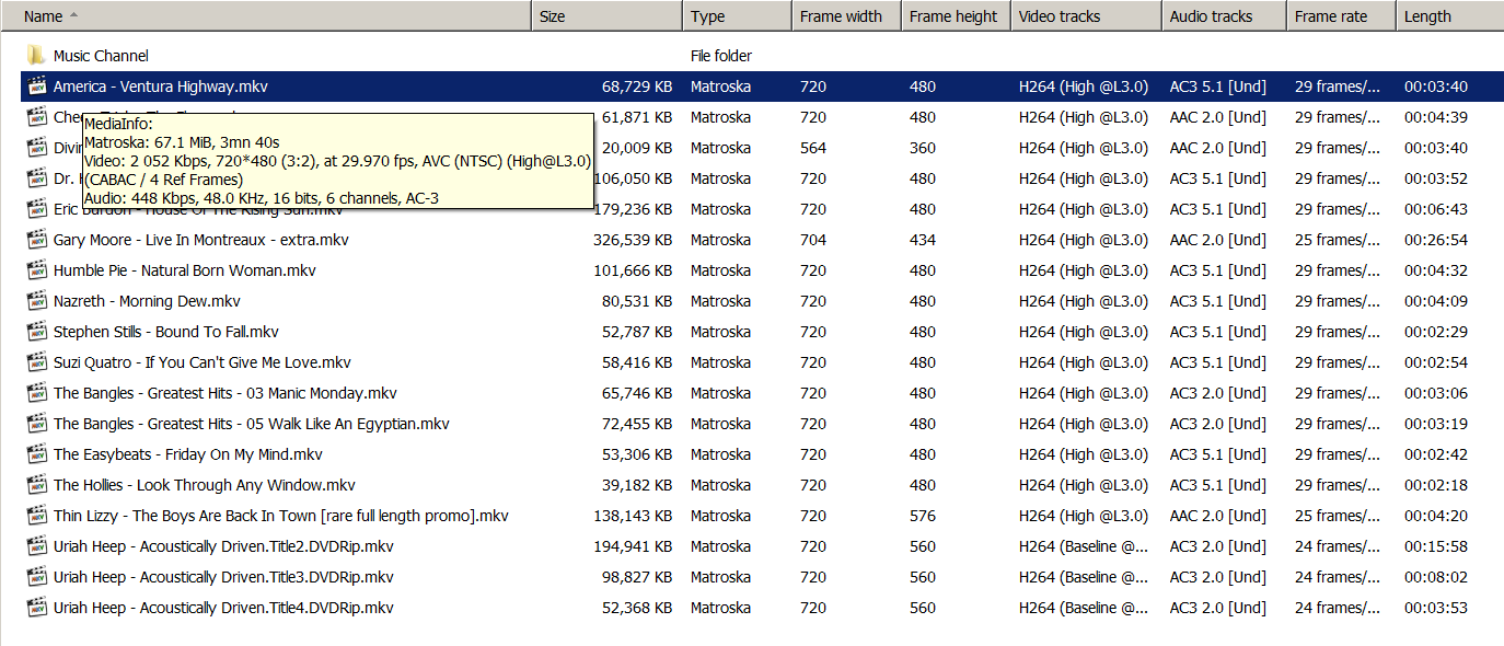

    Nov 2002
    That's weird cause last night it used MatroskaProp to show bitrate in MKVs but today it's using Mediainfo.
  11. @DarrellS - does it show it for AAC audio as well? or just AC3 ?
    Could it have to do with the splitter used (e.g. haali vs. lav ) ? or do you need a specific config for it to work ?
    Nov 2002
    Took a while to find MKV with AAC. Most of my MKV have AC3. No, AAC does not show bit rate in MKV and even worse, in MP4, it shows nothing for video or audio.
    I also have dBpoweramp and when I hover over an MPEG file, it shows all the audio info.
