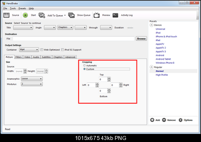

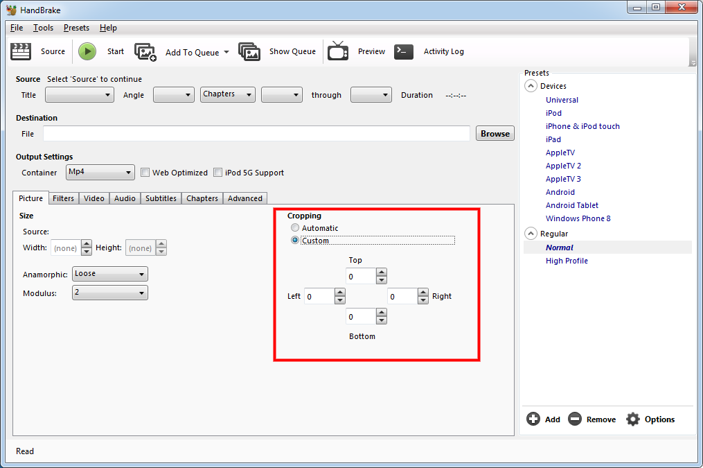

  2. Handbrake has cropping by the number of pixels at each edge:
  3. Brilliant
