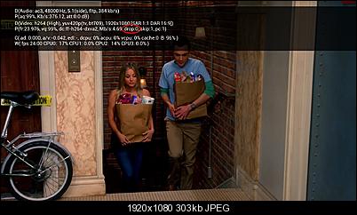

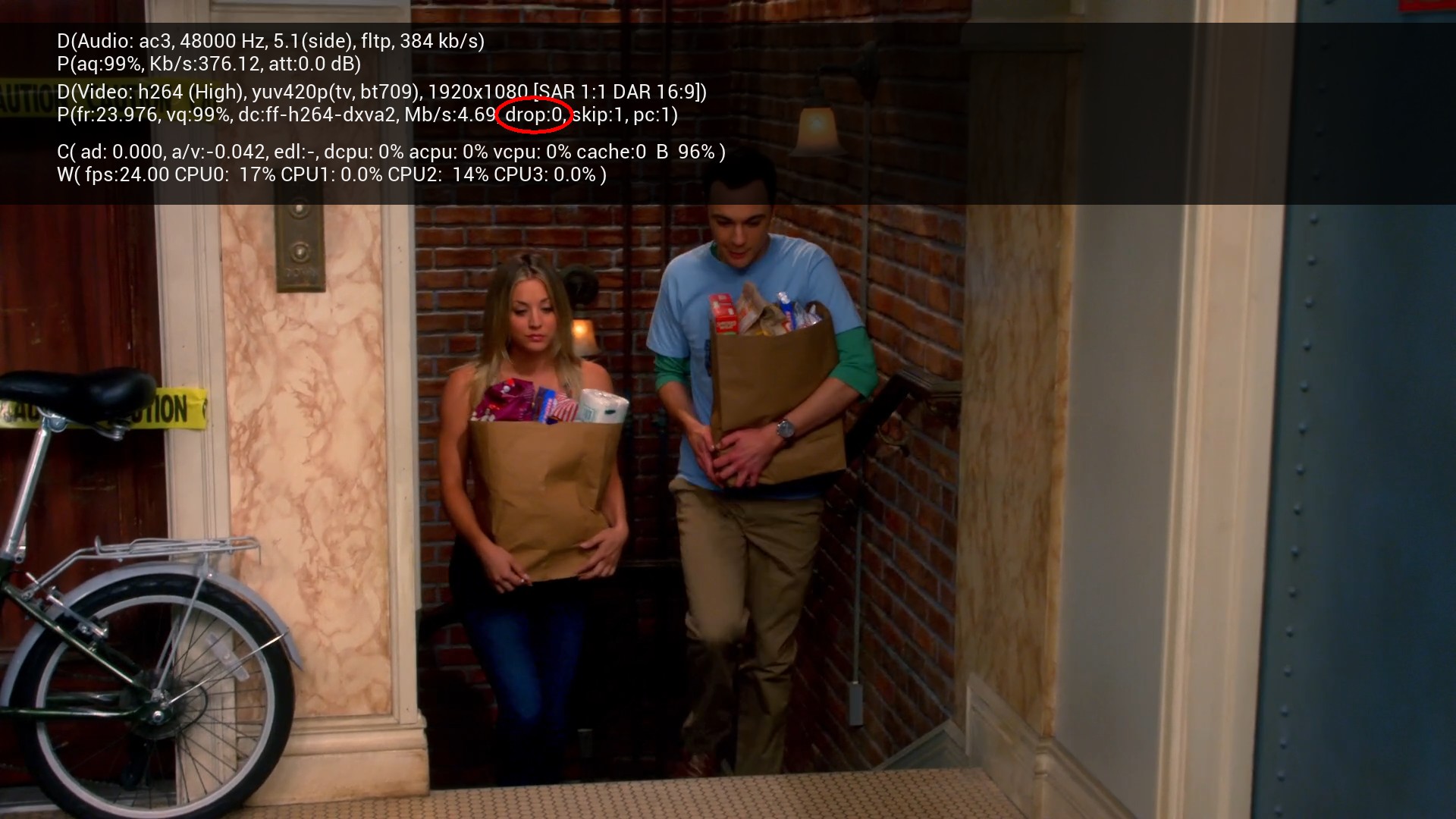

  4. Did you try play video files with Kodi (former name XBMC)?
    I have HTPC with far more slow hardware:
    CPU: Intel Atom D525 (dual-core) (1.8 GHz) GPU: NVIDIA ION on board, 4GB RAM
    and no problem to play 1080p files
    when you play file in Kodi and press on key "O", do you see drop frames?:
