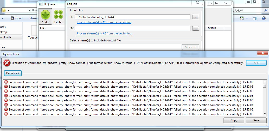

  10. Here's the bug of ffqueue

    That sure does look rediculess - never seen that before! What output do you get if you execute the command:
    ffprobe.exe -pretty -show_format -print_format default -show_streams -i "D:\Niloofar\Niloofar_HD.h264"
    In the console? Would be nice to know if this can be fixed in ffqueue or if this is related to a failure in ff-binaries
    I'm the developer behind FFQueue. My posts might reflect this! ;-)

  14. TorBru, I'm also a developer, however, the above snapshot occurs when I just open program, Input file #1, select my file D:\Niloofar_HD.h264
    So when I get into such trouble, I completely disregard the software.
    I was not using console and have no idea about that.
    However, read my signature to find what PC I was using?

    Sorry to hear you hate my program
    I've testet FFQueue very well. I have a harddrive full of old, mixed stuff including some broken vid's and I've never had the issue. Since you're having issues converting / remuxing your videos where one has bad video and the other has bad audio I assume that the problem is related to ffprobe crashing. However, FFQueue should not fire the same error repeatedly and I will fix that for the next update. If you would like to help me attemt to correct the issue completely, please please please (begging!) try the following:
    1) Go to the folder where ffprobe (ffmpeg) is located.
    2) Create a text file named "ffprobe.bat".
    3) Edit the file and enter the following command:
    ffprobe.exe -pretty -show_format -print_format default -show_streams -i "D:\Niloofar\Niloofar_HD.h264">ffprobe_result. txt
    4) Execute the batch file (double click).
    If ffprobe does not crash a new text file named "ffprobe_result.txt" has been created and that file would be interesting for me (attach it in this thread). It might event help us fixing the issue's with your videos
