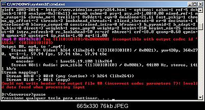

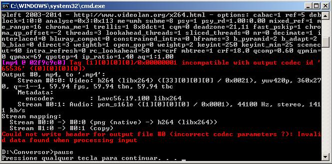

    I did tests and found that the error only happens if the conversion is to .mp4 and if the conversion is to .avi or .mkv works even using the audio .wav
  14. No uncompressed PCM in MP4, I guess. Compress the audio with AAC, MP3, or whatever.
  15. Member Belini's Avatar
    Aug 2011
    Brazil
    The problem that other people will also use, for while I removed the option to save in .mp4 format more right is finding the right setting to use in .wav format .mp4 too.
    If you find the correct command line to use .wav format .mp4 you can post so I make the correction.
    Download converter made in Autoit: https://www.dropbox.com/s/7xupm581sv76rgx/Mng%20to%20video%20converter.rar?dl=0
  16. If you leave out the "-acodec copy" you will get AAC audio at 128 kbps. Apparently the MP4 container doesn't allow PCM audio.
