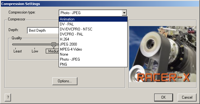

    I'm using old version PhotoShop 7 and have QTAlternative installed. I can import psd into ImageReady and export "Original" as a QuickTime Movie with optional codecs.
