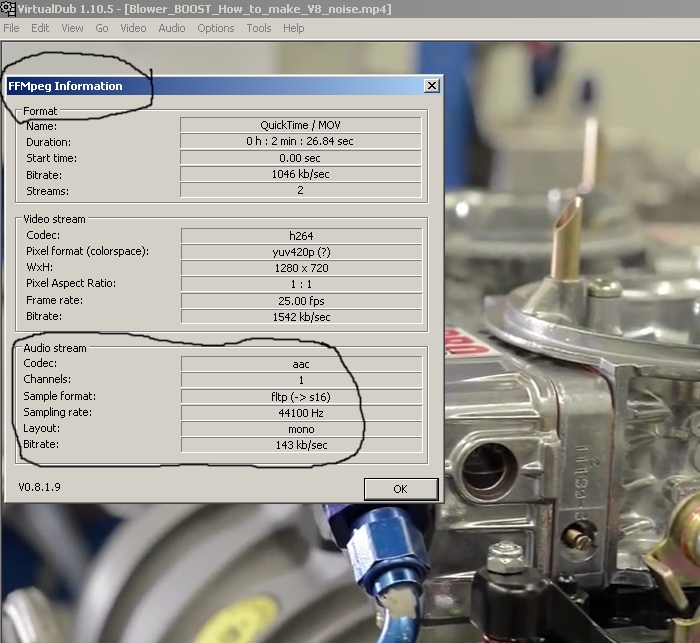

  12. Member racer-x's Avatar
    Mar 2003
    3rd Rock from the Sun
    And all you need is the latest version of ffmpeg input driver, nothing else. You don't need aac acm.
    1) Use the latest version of Virtualdub (I'm using v 1.10.5).
    2) Put the the ffmpeg plugin in the plugins32 folder.
    3) Drag and drop your MOV into Virtualdub.

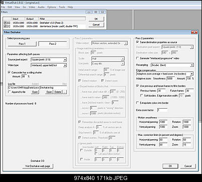

  20. You're basically going to have to decide whether you want the sky shaky or the cars shaky.
    Mar 2004
    France
    I'd rather have the sky shaky than the cars
    It looks super nice, thanks a lot
