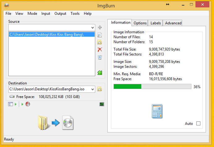

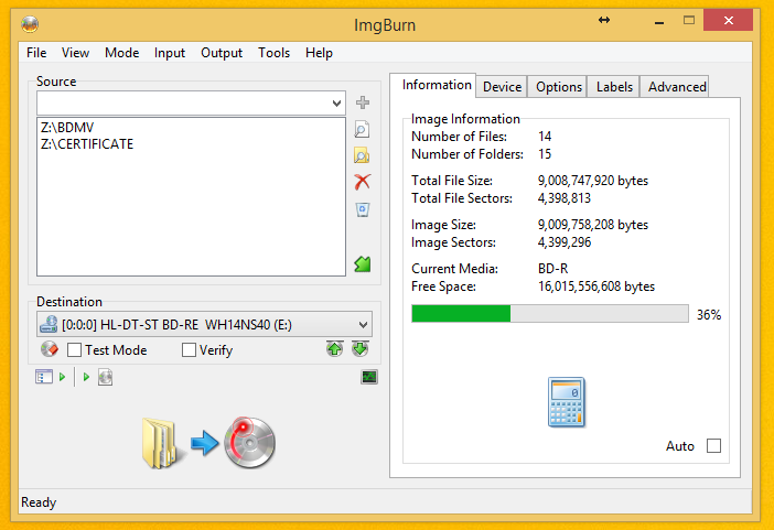

    Jan 2015
    Baldrick, thank you for the reply.

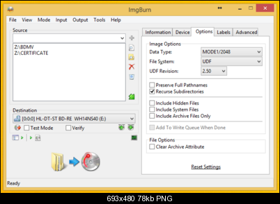

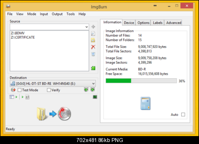

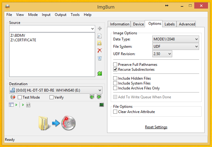

    I mapped the folder containing the BDMV and CERTIFICATE folders to the Z drive. I also used ImgBurn and it still doesn't work.
    Here is an image of the settings. This was an attempt to burn directly to the disc. I also tried saving the ISO to the hard drive with the same settings.

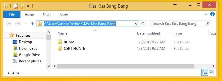

    Jan 2015
    gonca,

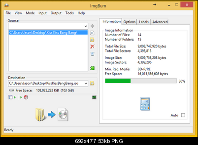

    Is this what you mean? I place the BDMV and CERTIFICATE folders into a folder on my Desktop called Kiss Kiss Bang Bang and then saved that folder as an ISO. It still doesn't play.

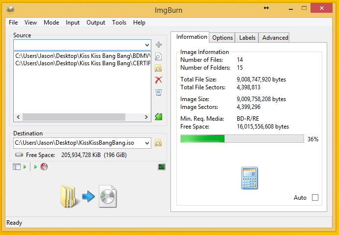

    Jan 2015

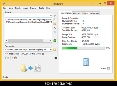

    I also tried adding them separately. Same result.

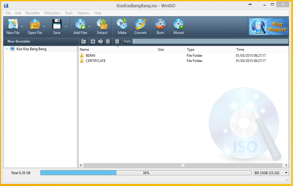

    Jan 2015

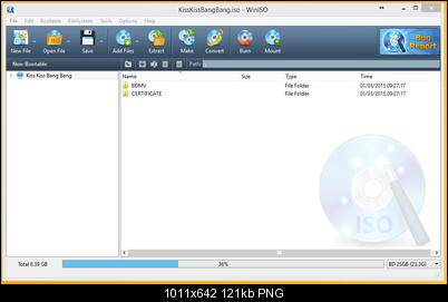

    This is the file structure of the ISO after it was saved.
