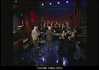

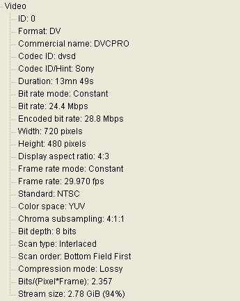

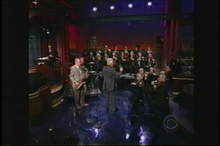

    Have DV captured off VHS that I'm converting to HD dimensions. Below I've made screen caps of the stages of the process - the ratio is slightly different because of dimension changes using HuffYuv but that's not the issue. During the process the color changes - there's a big difference between 1) and 4) - the image becomes darker. My goal is to retain the basic look of the original.
    Thanks for all input.

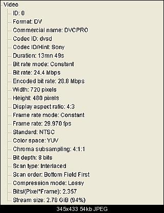

    1) The original interlaced DV avi
Name:	1 Original DV Interlaced.jpg
Name:	1 Original DV Interlaced info.jpg

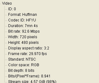

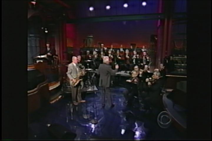

    2) Cleaned with NeatVideo and converted to Huffyuv with Virtualdub. Still interlaced. Colorspace is now RGB but it still looks basically the same.
Name:	2 Interlaced HuffYuv Neat.jpg
    Name:  2 Interlaced HuffYuv Neat info.jpg

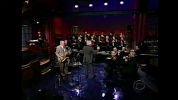

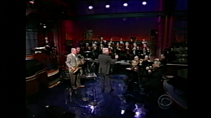

    3) Deinterlaced with QTGMC within Virtualdub - the basic look is still the same.
Name:	3 Deinterlaced QTGMC HuffYuv.jpg
    Name:  3 Deinterlaced QTGMC HuffYuv info.jpg

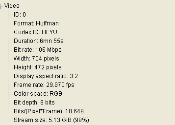

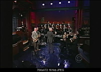

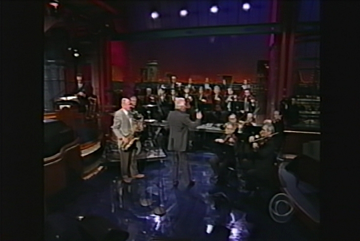

    4) Resized to 1080p using Vegas Pro 8 - resized here for space considerations. Here's where things change.
Name:	4 Upconvert to 1080p HuffYuv.jpg
    Name:  4 Upconvert to 1080p HuffYuv info.jpg
    Clearly there's a significant difference between 1 and 4 - again I'm talking about the color/contrast not the dimensions.
    Name:  Original resized.jpg
Size:  48.1 KB Name:  1080p resized.jpg

    Hard to tell from those pictures if (the level of) noise suppression is warranted, second I do not understand why you throw away 50% of information by discarding half of the frames during deinterlacing. Resizing is generally not a good idea as you cannot restore anything that is not there.
    It is probably best if you download a few frames in video format for each stage if you want to have feedback because those scaled images do not tell enough.
  3. You didn't change the colorimetry/color matrix when changing to Hi-Def? Also, it looks like the levels changed, maybe something you did or didn't do in Sony Vegas.
    The end result looks better to me as the source looks a bit washed out, but maybe that's because I'm on an uncalibrated monitor at the moment.
    Nothing that I deliberately set but I allow for the possibility that there's some setting in Vegas I'm not aware of.
    It doesn't look terrible but the main issue to me is some detail gets obscured by the darker areas - the whole point is to hang on to as much detail that's there as possible, not kill it. And I just want to have better understanding of the process and be able to steer it all more precisely.
  6. It's a rec.601 vs. pc.709 contrast stretch and color matrix.

  15. I downloaded image #3 and named it qtgmc.jpg, and image #4 and named it vegas.jpg. Then ran this script:
    q=ImageSource("qtgmc.jpg").Subtitle("qtgmc")
    v=ImageSource("vegas.jpg").BilinearResize(q.width,q.height).Subtitle("vegas")
    last=q
    ConvertToYV12(matrix="pc.709")
    ConvertToRGB24(matrix="rec601")
    Blur(0.5)
    Subtitle("qtgmc modified")
    Interleave(q,v,last)
    You'll see that "vegas" and "qtgmc modified" are nearly identical.
  16. Member Skiller's Avatar
    Oct 2013
    Germany
    So it's both a PC/TV-Levels mismatch as well as a 601/709 colorimetry mismatch.
    Vegas internally works in RGB so it will convert anything you import to RGB by itself unless it's already in RGB. So you should convert to RGB using AviSynth before you import the video in Vegas to avoid it's misinterpretation. However, all you do in Vegas is resize?! Why don't you do that in AviSynth?

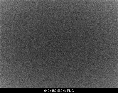

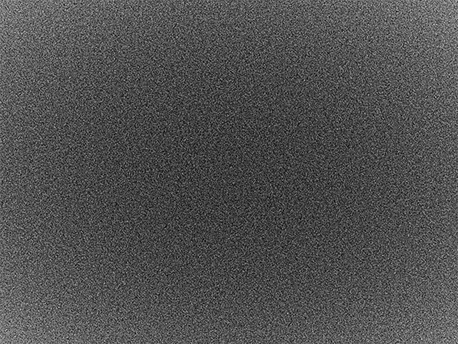

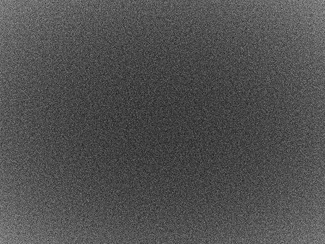

    As I test I took a 562KB 640x480 PNG file
    and uploaded it uncompressed to Youtube:
    http://www.youtube.com/watch?v=3tbkNV9oV2w

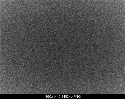

    Then I upconverted the original PNG file into a 2483KB 1920x1440 PNG file
    http://www.youtube.com/watch?v=jLmZpmH1v34
    Retrieving both videos gave me file sizes of: 71 and 209 KB.
    For the SD video the compression rate is 7.92 while for the HD video this rate is 11.88.
    The resulting files retrieved from Youtube are here:
    480 Test.mp4
    Upconverted 480 Test.mp4
    If we then 'difference' the original files with the returned video the result is dramatically worse for the upconverted case.

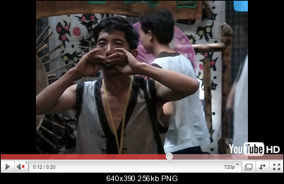

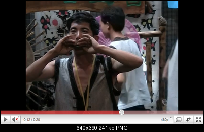

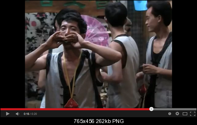

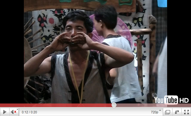

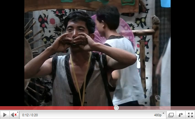

  20. Do you think random noise would be a "typical" upload for YT ? The compression characteristics would be different than "normal" content
    Here is one, quality is pretty shitty, it was upscaled DV but that's going to be "typical" for these SD uploads. Like the OP , it was deinterlaced with QTGMC , upscaled similarly to the OP. I can't find the thread where it was discussed - I think the topic was bitrate distribution by appending still segments vs. all action or something like that. That's why there are those stupid titles if you look at the video
    You can tell from the old YT viewer, that is old (2010)
    480p 2010
Name:	3 - 720-480.png
    720p 2010
Name:	3 - 720.png

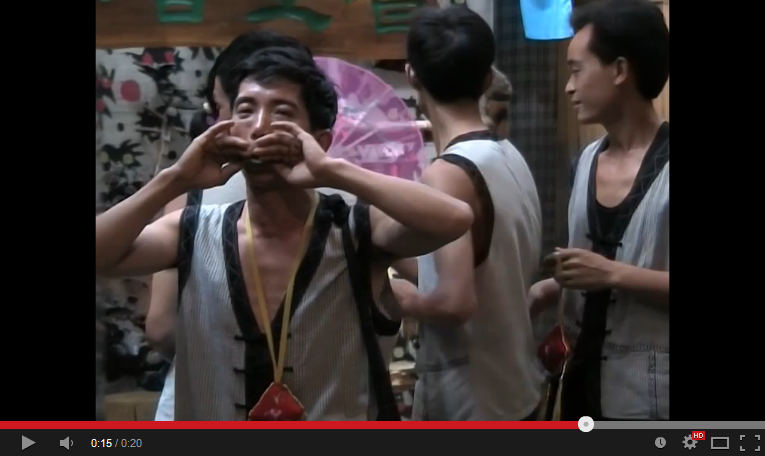

    I found the original file on an old HDD. 2015 reupload, does YT treat it any differently?
    http://youtu.be/zgbAI5tjEKQ
    480p 2015
    720p 2010
    You can download the actual video versions and compare offline if you want. Interesting that no audio was uploaded, but YT encoded blank AAC audio for both. 192kbps vs. 126kbps
    In this test, the fine details are retained more, like the patterns on the vest. The dark areas and background details seem to be retained more as well, instead of being smudged away

    bits / pixel or similar metrics are usually frowned upon, because the compression curve relative to frame size is non linear (ie you don't need 2x more bitrate for 2x as many pixels to achieve a certain level of "quality" )
    It's not demonstrated here in the screenshots, but another reason why 720p viewed at 720p (or 1080p viewed at 1080p) might look better is flash/YT upscaling algorithm is poor. By viewing the larger version, you "force" your upscaling method instead of relying on flash/YT. But regardless of up or downscaling algorithm , that 480p version clearly has details missing that the 720p version retained
  21. Banned
    Oct 2014
    Northern California
    It would not but it is arguably more objective to check the differences between a random standard and upconverted original than comparing sharp straight and angled lines as is typically done to 'prove' the 'great merits' of upconversion.
  22. Originally Posted by newpball View Post
    And these low level tests, such as test patterns, noise, luma ranges, chroma ranges are important to conduct. No arugment there
    But the "upscaling" for youtube isn't so much about the antialiasing or upscaling itself. It's more about how YT handles HD material vs. SD material. It undergoes a different pathway, and gets different treatment leaving you slightly better results. This behaviour might change anyday - YT is always changing their behaviour and policies
    Another interesting tidbit, is the 480p version of the 720p version, looks better than the 480p version of a 480p version upload. The difference isn't as large, but still present.

    for op, Vegas treats different videos differently, you might just apply "computer RGB to studio RGB" effect to bring levels down for your lossless or whatever it is you load into Vegas
    and yes 720 should be enough, 1080 is not necessary
    Yes - I've noticed that as well. The 480p version of a video that was uploaded HD looks better than one that was only uploaded as SD.
