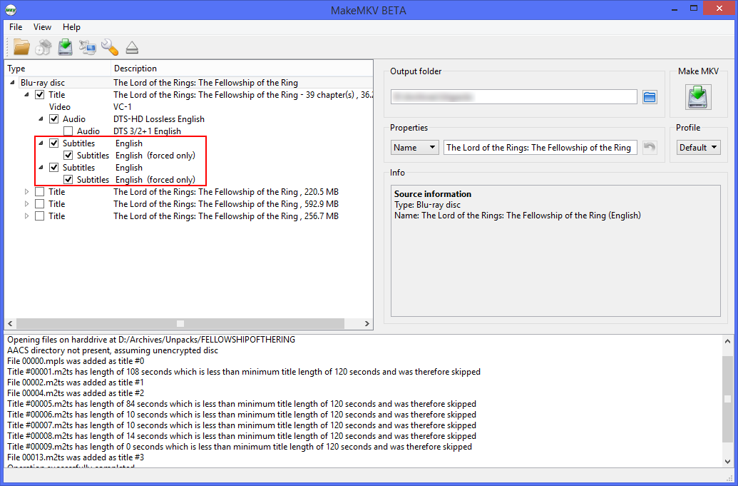

  2. Still confused by the above mentioned BR disc. Screenshot below shows it loaded into MakeMKV.
    The two subtitle streams are as follows. 1. Full subs for whole movie. 2. Forced subs for place name and and non English spoken parts only. But both show English (forced only)?

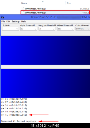

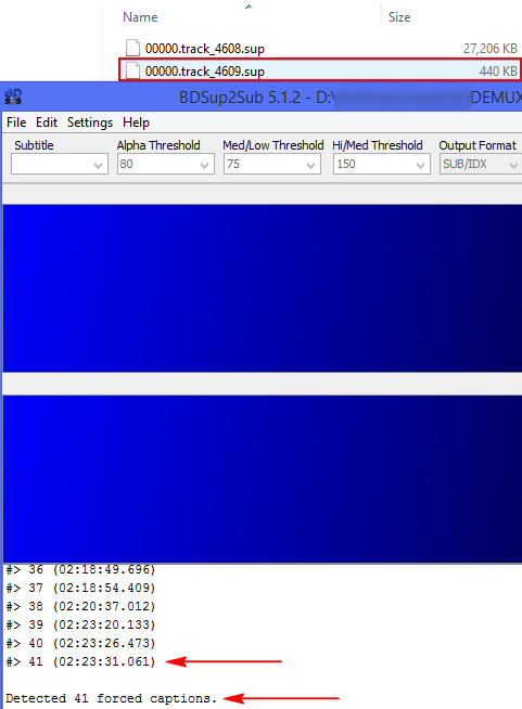

    Since you are using TsMuxer >> Demux the subtitle streams (SUP)
    Load into bdsup2sub
    It will identify forced streams or forced entries in those streams
    bdsup2sub>> Export forced only -- pick output format
    New stream with only forced subtitles
    Remux back into file
  8. Many thanks both of you.
    Just quickly tried your suggested method and yes BDSup2Sup quickly identifies forced subs, be they flagged or as a separate stream. Obviously being new to ripping BR I hadn't realised that quickly demuxing sub streams and loading into BDSup2Sub would reveal all regarding the forced subs. Again, cheers both of you.

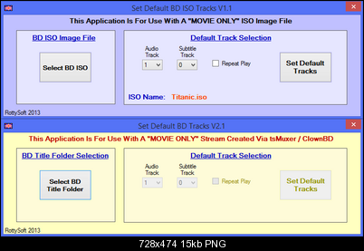

  10. Nucleus found this tool on the Slysoft forum:
    https://forum.slysoft.com/showthread.php?59584-Movie-Only-ISO-Forced-Audio-and-Subtitle-Editor
    I registered just to be able to download and test it. Anyone here familiar with it? I'm having a go with it now.
    It seems that fooling with forced subs is not something members here need to do very often. As evidenced by the lack of response to my BDEdit mini-guide:
    https://forum.videohelp.com/threads/365145-How-to-turn-on-subtitle-by-default-on-movie-...39#post2328339
    It worked for me on a few test discs. If someone would be so kind as to give it a go and report? If I could get a member or two to verify it worked for them, I'd ask Baldrick to post it in the Guides section as a Forced Sub/ Default On Sub (BDEdit) guide.
    Pull! Bang! Darn!

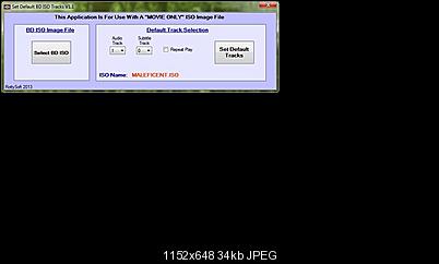

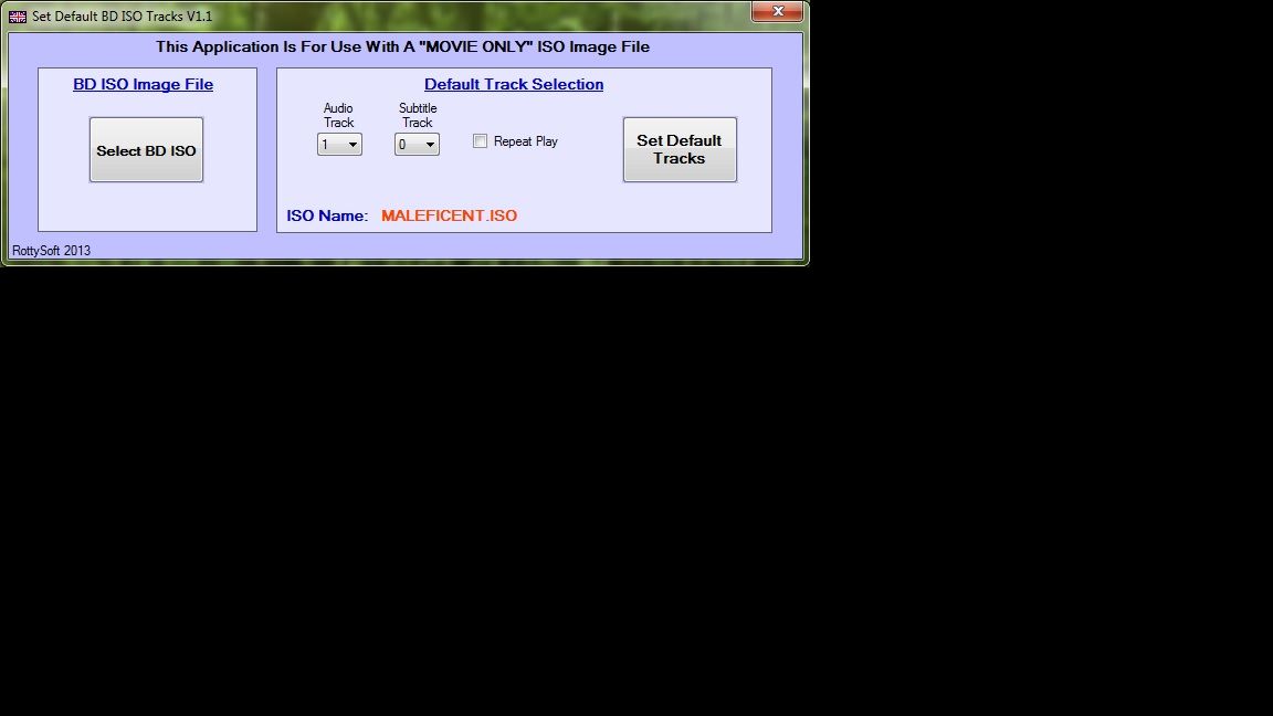

  12. Thanks, I'm doing Avatar right now to double-check.
    Anyway, I tried out that program: Set Default BD ISO Tracks v1.1. It worked for setting the default audio track and for turning on a subtitle track.. Very minimalistic. I could wish it would do BD files as well as ISO, but hey...I'm going to submit it for putting in the Tools section.
Name:	Set Default.jpg
    Pull! Bang! Darn!

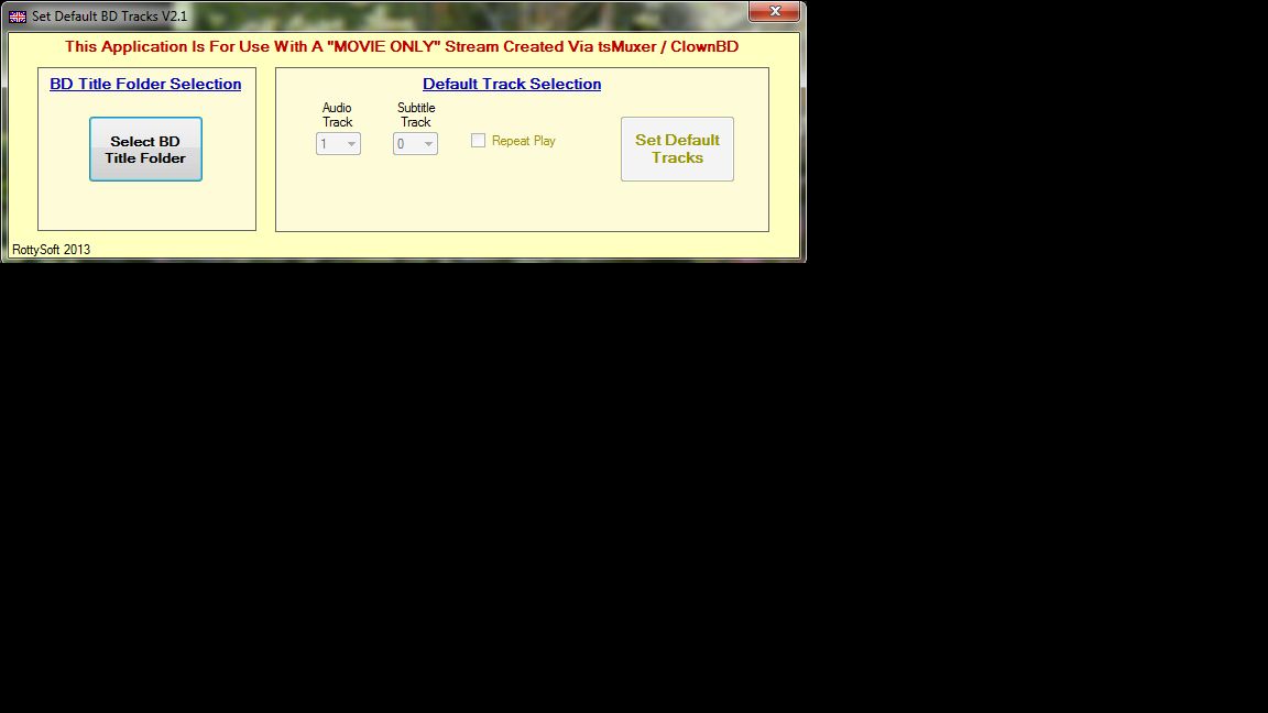

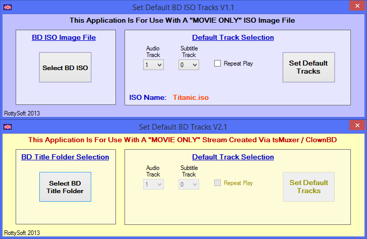

  13. Originally Posted by fritzi93 View Post
    Mentions in first post that if you need the BD folder version, scroll down and select v2.1.

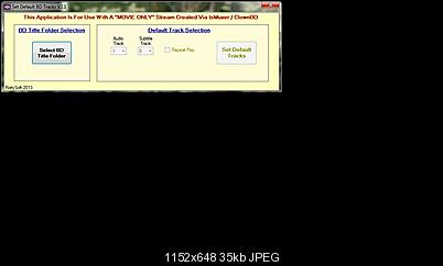

  14. Okay, I missed that.
    Submitted for Tools section.
    Pull! Bang! Darn!

    rem checking if this stream was already logged
    if exist forced_subtitle_list.txt for /f "tokens=*" %%g in (forced_subtitle_list.txt) do if "%%g"=="%~dp1%subt_name%%extension%" echo subtitle track %stream%: was already logged in ^"forced_subtitle_list.txt^"& goto :eof
    rem detecting no forced, just regular captions
    if /i "%~5"=="captions."  if /i "%~6"=="" echo subtitle track %stream%: containes %~4 captions
    rem detecting pure forced subs
    if /i "%~5"=="forced"  (
    	   echo subtitle track %stream%: containes %~4 forced captions
    	   call :log_forced "%~1"
    	   set "forced_detected=yes"
    rem detecting regular captions and forced
    if /i "%~5"=="captions," if /i "%~7"=="forced" (
    	  echo subtitle track %stream%: containes %~4 captions, %~6 forced captions
    	  call :extract_forced "%~1" %~4 %~6 %stream%
    rem detecting regular captions and forced with the word "normal" in it
    if /i "%~5"=="normal" if /i "%~6"=="and" (
    	  echo subtitle track %stream%: containes %~4 captions, %~7 forced captions
    	  call :extract_forced "%~1" %~4 %~7 %stream%
    goto :eof
    :extract_forced <demuxed folder> <number of captions> <number of forced> <stream>
    echo Command line to extract forced subtitles from track %4:
    echo "%path_java%" -Xmx256m -jar %BDSup2Sub% "%~dp1%subt_name%%extension%" "%~dp1%subt_name%_extracted_%3FORCED.sup" /forced
    echo extracting forced %subt_name%_extracted_%3FORCED.sub ...
    ver>nul
    "%path_java%" -Xmx256m -jar %BDSup2Sub% "%~dp1%subt_name%%extension%" "%~dp1%subt_name%_extracted_%3FORCED.sup" /forced > "%~1\%subt_name%_extracted_%3FORCED.LOG"
    if not %errorlevel%==0 (
       echo    ERROR, BDSup2Sub failed to extract forced subtitles from:
       call :print_path "%~dp1%subt_name%%extension%"
       echo           Maybe there is wrong java.exe path in your INI file
       goto :eof
    if not exist "%~dp1%subt_name%_extracted_%3FORCED.sup" echo    ERROR, this subtitle was not extracted: %subt_name%_extracted_%3FORCED.sup & goto :eof
    echo(%~dp1%subt_name%_extracted_%3FORCED.sup>>"%~1\forced_subtitle_list.txt"
    goto :eof
