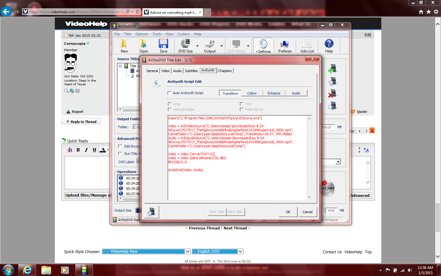

    Thanks. I guess the 0,1 is the level? so if I wanted to change the level of the blur id do like a 1,5 or a 2,0?
  16. Member Cornucopia's Avatar
    0 is the Horizontal. 1 is the Vertical. Both are levels. Read the Manual regarding Blur to adjust according to your needs.

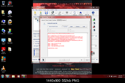

    so like this?
  18. Sorry, double post.
  19. Video=Video.Blur(0,1)
    Put it before the resize.
    Dec 2014
    New York

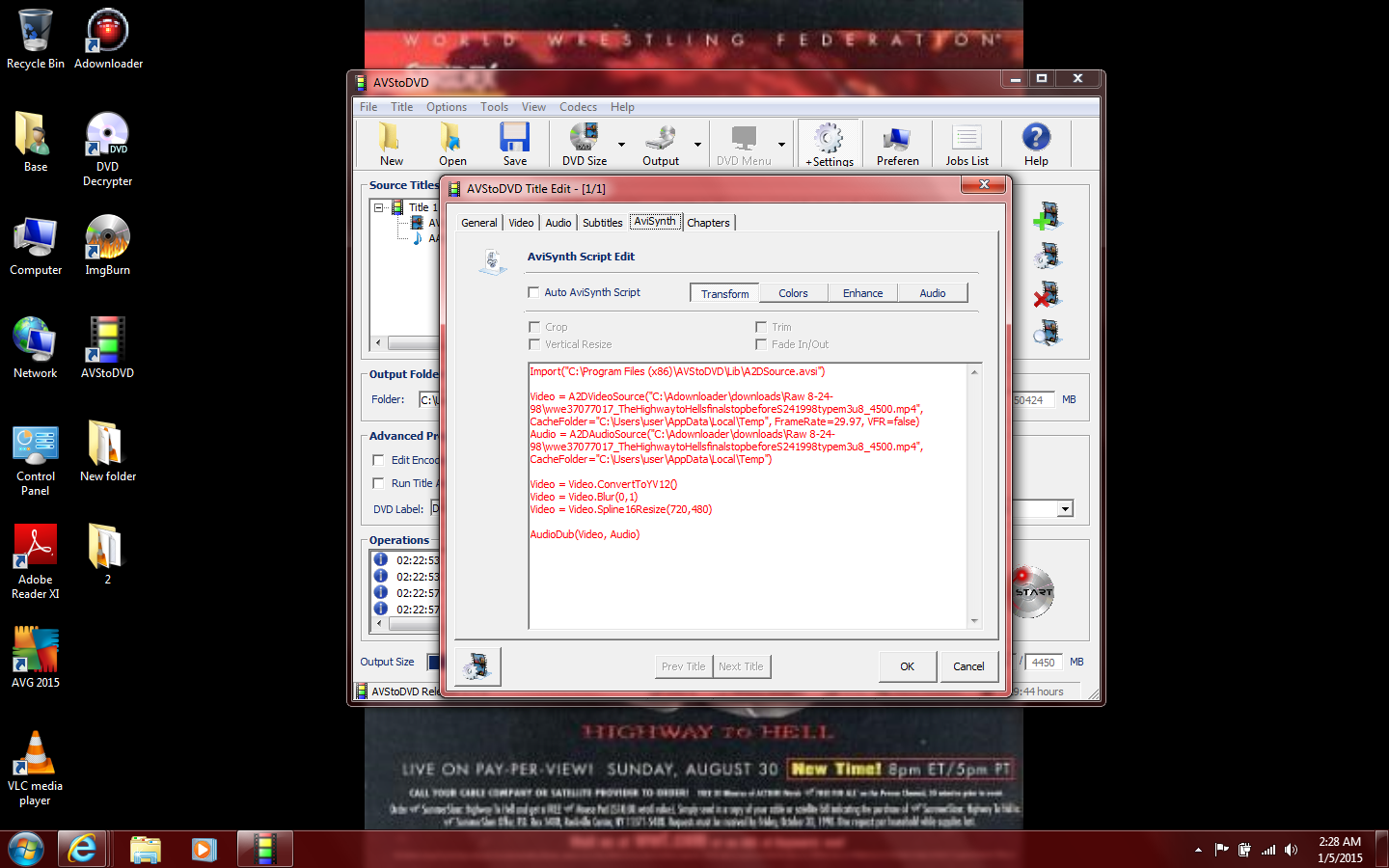

    Ok so like this?
    Should I enter a greater amount than 1?
    EDIT: When I enter 2 it seems like it doesn't work but I just tried 1.5 and it seems like its encoding.
  21. Member Cornucopia's Avatar
    Hey, how about losing the screencaps and just posting the text - makes for much easier reading!
    Like that looks pretty good.
    Did you read the manual on Blur? It tells you the max value is ~1.58 (and min value is -1.0, but you don't really want anything less than ZERO - it becomes a sharpen then). Pick one that works for YOU. Do so by using TRIM() to test a short segment, and try 0.25, 0.50, 0.75, 1.00, 1.25, 1.50 variations.

    I mean after I did the encode with the blur and spline36resize. I think the problem might be with my script cause when I revert the script to normal the audio problem doesn't happen.
    What happens is the audio plays really fast almost sounds like the chipmunks and for most of the video its silence.
    Heres my script
    Import("C:\Program Files (x86)\AVStoDVD\Lib\A2DSource.avsi")
    Video = A2DVideoSource("C:\Adownloader\downloads\Raw 8-24-98\wwe37077017_TheHighwaytoHellsfinalstopbeforeS24 1998typem3u8_4500.mp4", CacheFolder="C:\Users\user\AppData\Local\Temp", FrameRate=29.97, VFR=false)
    Audio = A2DAudioSource("C:\Adownloader\downloads\Raw 8-24-98\wwe37077017_TheHighwaytoHellsfinalstopbeforeS24 1998typem3u8_4500.mp4", CacheFolder="C:\Users\user\AppData\Local\Temp")
    Video = Video.ConvertToYV12()
    Video = Video.Blur(0,1.25)
    Video = Video.Spline36Resize(720,480)
    AudioDub(Video, Audio)
    __________________________________________________ __________________________________________________ __________
    EDIT: Just changed the AC3 encoder to ffmpeg(safemode) and did a test run and it semmed to work with the blur and resize. I had the setting at the default wavi+aften before have no idea why that setting doesn't work anymore.
