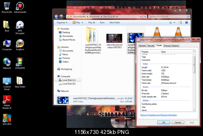

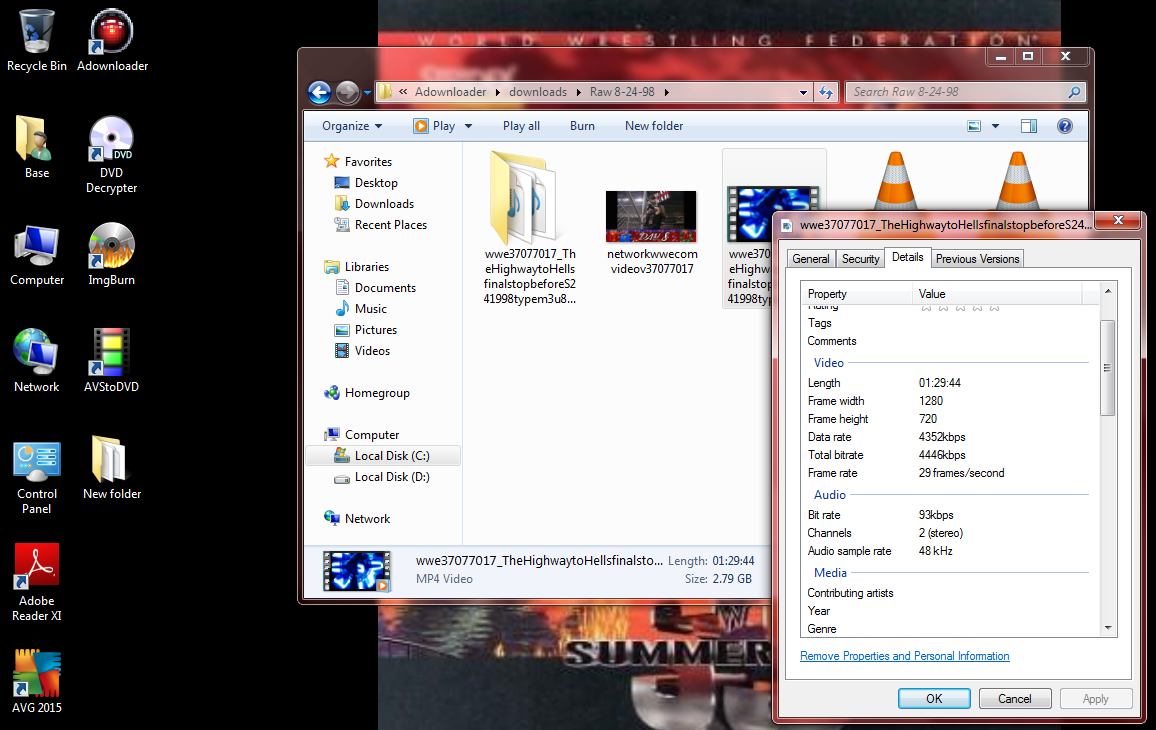

    Heres the properties for the original fileClick image for larger version

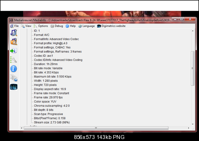

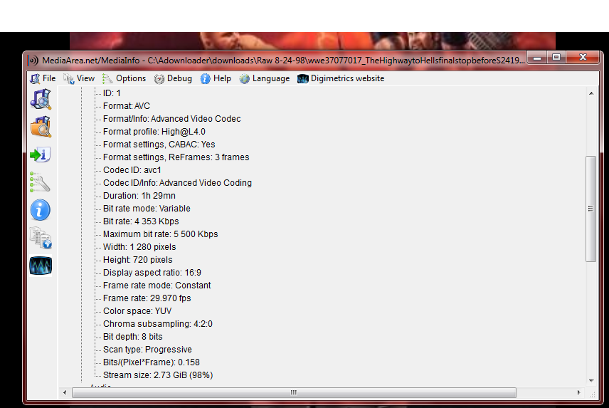

    So its 29.97. So I should change it to interlaced? Ive read somewhere else that you shouldn't change the source type. You should leave it as is? Some more on this would be appreciated.
  27. Member Cornucopia's Avatar
    That doesn't say if it's already interlaced or not. Use MediaInfo to tell.
    If it's 29.97 interlaced (aka 59.94 interlaced), you should LEAVE it that way.
    If it's 59.94 progressive, you should do something like:
    AssumeFrameBased
    SeparateFields
    SelectEvery(4, 0,3)
    Weave()
    That will make it 29.97 interlaced.
    If it's 29.97 progressive, you should leave it as it is, and there is no proper way to get better TRUE motion (there are a few ways to fake it, but might look fake). For DVD encoding, you would want to encode as PsF with a flag (because DVD expects it to act like it's interlaced). This can be done like a 2:2 pulldown.
    What are you talking about, "source type"? There are things you shouldn't do without good reason. Depending, it's possible this might be one of those good reasons.
    Im sorry I said source type I meant scan type. Heres the properties
    So it looks like its 29.97 progressive.
