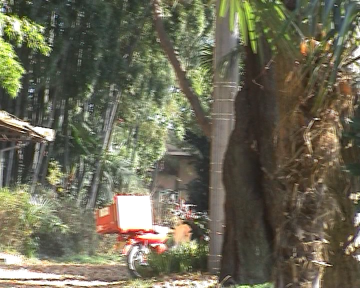

  3. Post screenshots of frame 25 for example. I will post mine here, use:
    ConvertToRGB(matrix="Rec601", interlaced=true)
    source...............vdub
  4. Your screenshots match
    Mine don't. Taken with avspmod
    ffms2 and converttorgb24(matrix="rec601", interlaced=true)
Name:	25 chunky.png

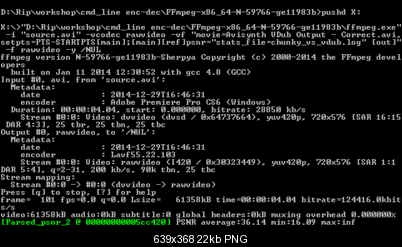

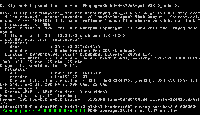

  5. Try ffmpeg psnr on your files
    ffmpeg -i "cacho01 vdub.avi" -vcodec rawvideo -vf "movie=chunky.avi,setpts=PTS-STARTPTS[main];[main][ref]psnr="stats_file=chunky_vs_vdub.log" [out]" -f rawvideo -y /NUL
  6. poisondeathray, the only disparities found in the videos are quantization blocks, it's the type of difference you find for decoding. I think ffmpeg is applying internal deblocking to the DVCPRO file, test it by converting the DVCPRO file to Lagarith and repeat the process. Maybe it's that (or maybe not).

    Here is my log.
  9. There are errors in your log, some frames don't match
    And here is mine, when re-encoded with lagarith, to test with ffmpeg psnr

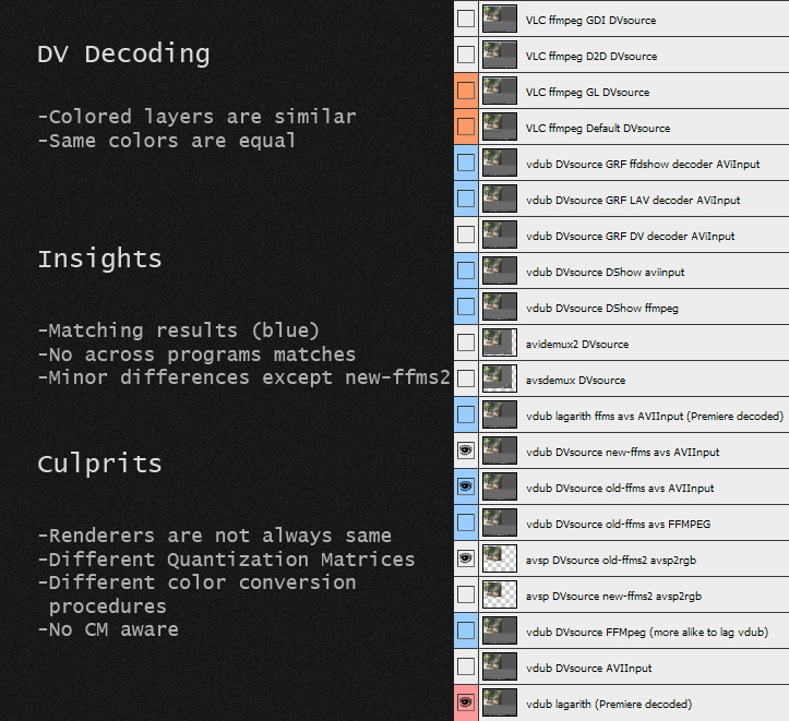

  17. Member Cornucopia's Avatar
    +1 on pdr's assessment.

  23. I use photoshop for various reasons, it's easy to zoom in, pan, I can zoom much more, I can do comparisons of more than 2 sources with layers, and it's easy to compare and undo the comparison (F2 and F3 action respectively). It doesn't matter if the yuv to rgb conversion is crap, they are the same crap so testbed doesn't change, I'm only spotting differences.
    I just tested on XP, and I get the same behaviours than on 7 x64. The old ffms2 is same as the one decoded by Premiere, and the more recent ones not. If we are over with the I'm wrong you are wrong, we can try to hunt for the bug, test some more ffms2 and avs versions and check what is happening. Tomorrow, today is a day for me.
    I do understand enough to know you have better alternatives:

  30. First and foremost, this is not a straight lossless discussion, this is a DV decoding discussion.
    I'm very procedural when it comes to systems, I build my own OS images, I know what I have or what I'm missing. I know what I install and what is running in my system. Just in case, letting you know that I wasn't handed a PC yesterday.
    For all the people getting differences let me please remind you this post of me above, I also do get different outputs if you decode with latest ffms2 builds.
    Carrying on with my benchmark, I get no differences in vdub using either the AVIInput driver or the FFMpeg when loading avs scripts.
    Getting different results in different programs is normal because they use different renderers, different color format conversion tables or even quantization matrices, I think I have to remind you that you are not going to get the same decoded output of a jpeg image when loaded in avisynth/vdub and in Photoshop because loose standards. This is what happens specially with old codecs. So you need to keep your testbed, in my case vdub.
    What is good to know is that there is a pattern in my results (blue layers), I wouldn't say that a failed benchmarking manages to get so different decoders as ffdshow, LAV, Premiere and the old ffms2 to match.
    The rest of the colored layers are very similar, and all of them except the new ffms2 builds only differ in chroma (as I said, different color conversion implementations, etc). For me this is a solid result to trust, I would rather trust four core program matches than a stranded ffms2 implementation of DV decoding.
    The only mystery going on is why you get same results on all ffms2 builds.
    Benchmarks in PSD (10Mb)
