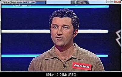

    Just a quick question here, because I'm still trying to learn... I downloaded the video and it showed:
Name:	ScreenHunter_132 Dec. 29 11.15.jpg

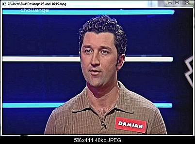

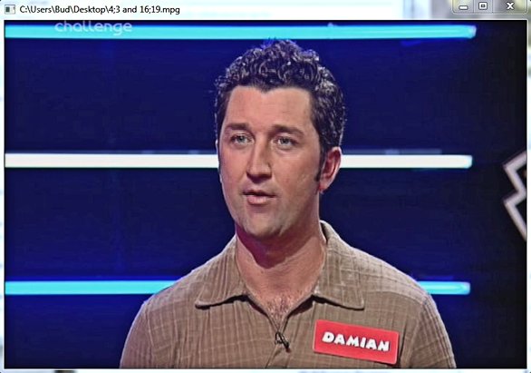

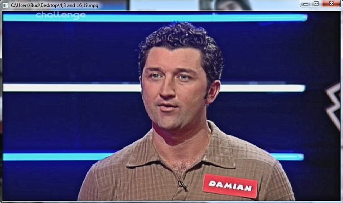

    So I cropped and resized to 16/9 and 3/2:
Name:	ScreenHunter_132 Dec. 29 11.09.jpg
ID:	29339Click image for larger version
Name:	ScreenHunter_132 Dec. 29 11.08.jpg
    Are these wrong and how would I know the size it should be?

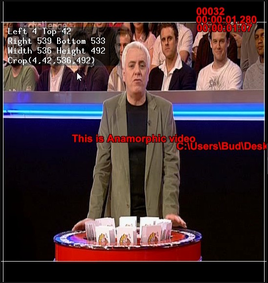

    Please pay no attention to the Anamorphic note. It's my program I haven't fixed yet.
