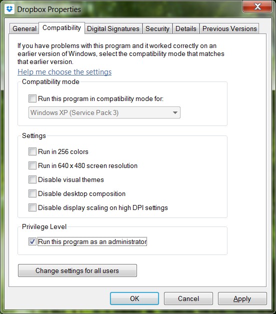

  9. So set Dropbox.exe run as administrator:

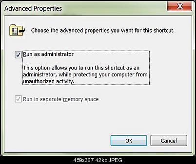

    or you can disable Dropbox autostart and make Dropbox shortcut in startup folder
    with set shortcut advanced properties also:
