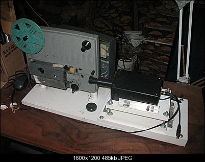

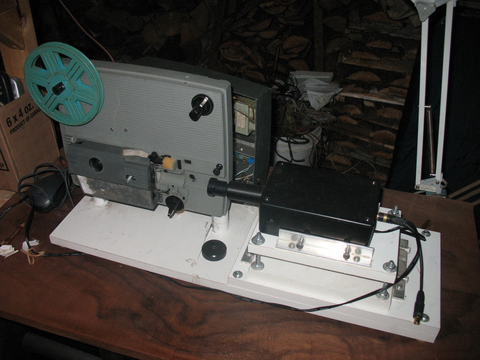

Transferring film to DVD is quite a technical feat, and I admit I still have a lot to learn especially when it comes to optics. But anyway..... the setup I currently use one that was purchased on eBay for around $2k, I bought it second hand for cheap as it needed some repair. I do not know exactly who made it. I've attached a picture of it; as you can see, the projector is on the left and a camera (currently a Sony Exwave) at the right. The projector lens has been removed, and a special zoom lens attached to the camera that allows it to shoot directly into the projector gate. Each frame is captured individually using stop-motion capture software, and a modified mouse that connects to the projector. As you may have guessed, post-processing is required to correct the orientation of the image. Otherwise, this produces very good results, but the biggest disadvantage is that I'm limited to using a camera that will accept this particular lens. What I want to do, is modify this so I can use any common HD camcorder without having to make any modifications to the camera itself.
