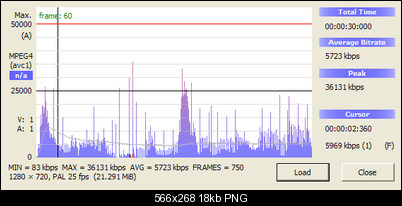

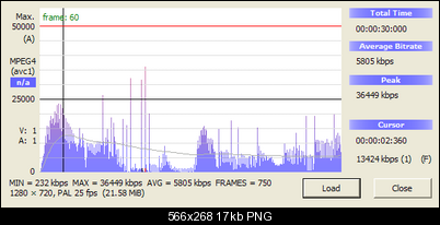

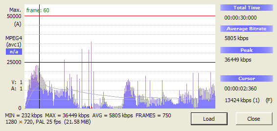

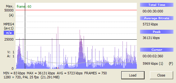

  7. I looked at the samples in the last post in the Adobe thread.
    I'll reply here, but it should be 3am Digital Studio's responsibility to reply to the Adobe thread.
    Yes there are some quality issues with the x264pro encode. But to be fair , they didn't use apples to apples same settings
    The x264 (CLI) encode (slow) uses 5 reference frames, unrestricted VBV, 2 passes
    The x264pro encode (slow) uses 4 refrence frames, --vbv maxrate 12000, --vbv-bufsize 30000, 1 pass ABR, with --psy-rd 1:0.15
    The biggest deterioration in visual quality to the naked eye is in the intro section with the sparkling graphics. It requires a lot of bitrate to encode that type of content because there are a lot of changes between frames . Recall the temporal compression (Long GOP compression) stores the differences between frames . Lots of change, means lots of bitrate required. The VBV restriction is the main cause of that deterioration, although 2 passes vs 1 pass plays a role as well. A larger maxrate will allow more bitrate to enter the buffer, or a larger buffer would have allowed larger allocation to where it was needed. Right now the maxrate is set to 12000kbps, so x264pro will only allow 12000kb and any given second to enter the buffer. The requested amount for an unrestricted encode is much larger. If you look at the bitrate graph for the unrestricted encode, it's well over 12000 for that entire intro period. When using VBV, x264 won't let you empty the buffer (buffer underrun), so it allocates less bitrate to that section. Compare the bitrate graphs below (open them in different tabs and flip back & forth) and look at the "fullness" of that beginning period . VBV settings should only be used if there was a specified reason like a target device. I don't know if the x264pro GUI allows you to adjust these types of VBV or advanced settings, or what the actual target was for this particular test
    psy-rd and psy-trellis will tend to make edges and encodes noisier, unless you have adequate bitrate. So that combination of higher psy-trellis along with low relative bitrate allocation in that section will cause quality problems
    "x264 (Slow) = 59 sek.mp4"
    "x264 PRO (Slow) = 53 sek.mp4"

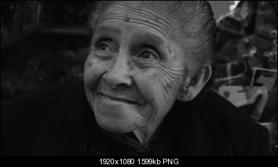

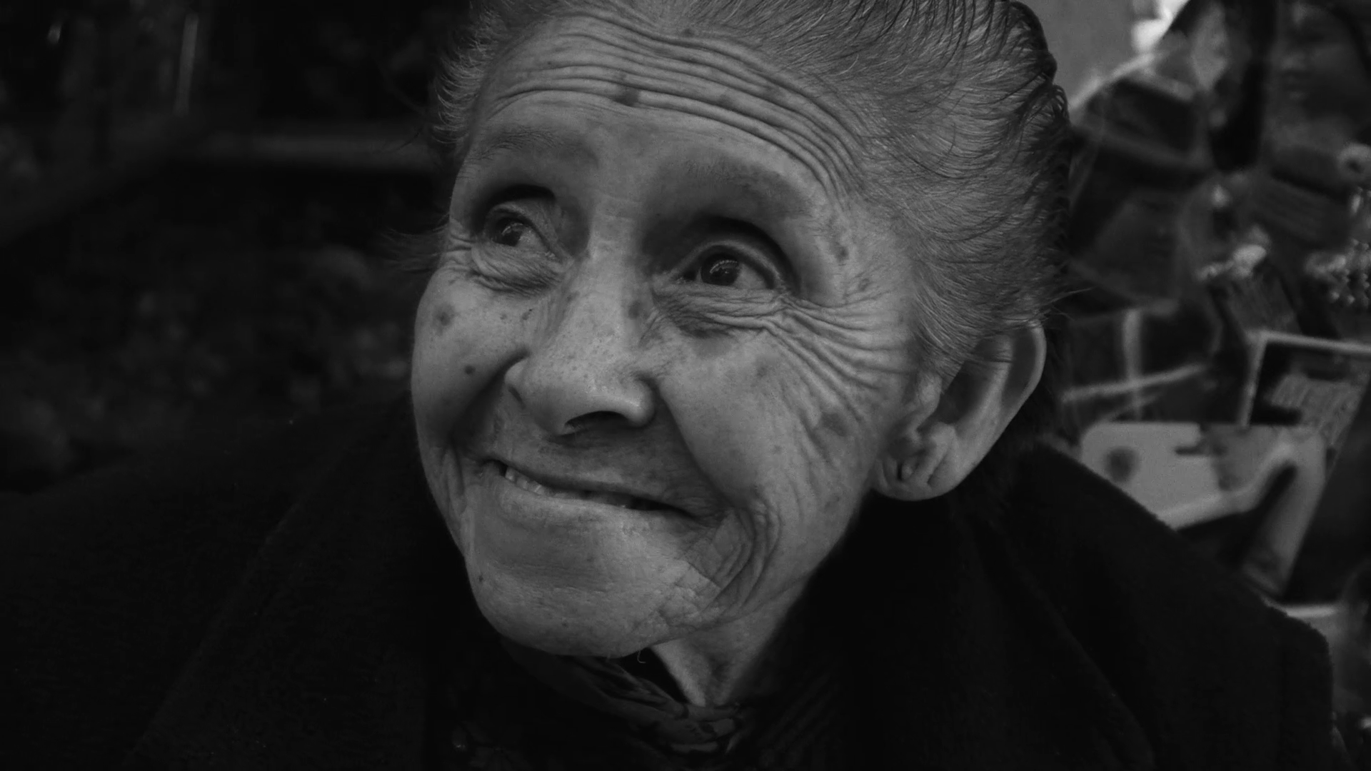

  8. First off, thanks so much to you, poisondeathray, for all the help…really incredible!
    The results I've been getting with x264 totally just blow MainConcept's stuff out of the water, it's insane. Lots of pics below for everyone to see for themselves.
    Settings for both (tried to match as closely as possible)...
    Premiere: VBR 2 pass, avg target bitrate 8000 kbps, max 50000 kbps, 1080p 23.976fps. Final size: 328 MB
    HandBrake x264: VBR 2 pass, avg 8000, preset veryslow, tune film, profile/level auto, 1080p 23.976 constant framerate. Final size: 326.8 MB
    Only minus I saw was some strange artifacts in Quicktime X, I'll post a screen shot below.
    But first, the comparisons:
    Test 1
    Master (straight from Premiere sequence)
Name:	Export Comparisons3.Master.png
    ProRes (just in case, for reference)
Name:	Export Comparisons3.ProRes.png
    MainConcept
Name:	Export Comparisons3.MCH.264.png
    x264
Name:	Export Comparisons3.HBx264.png

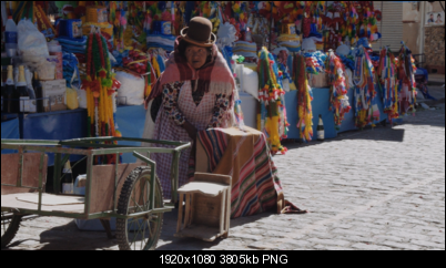

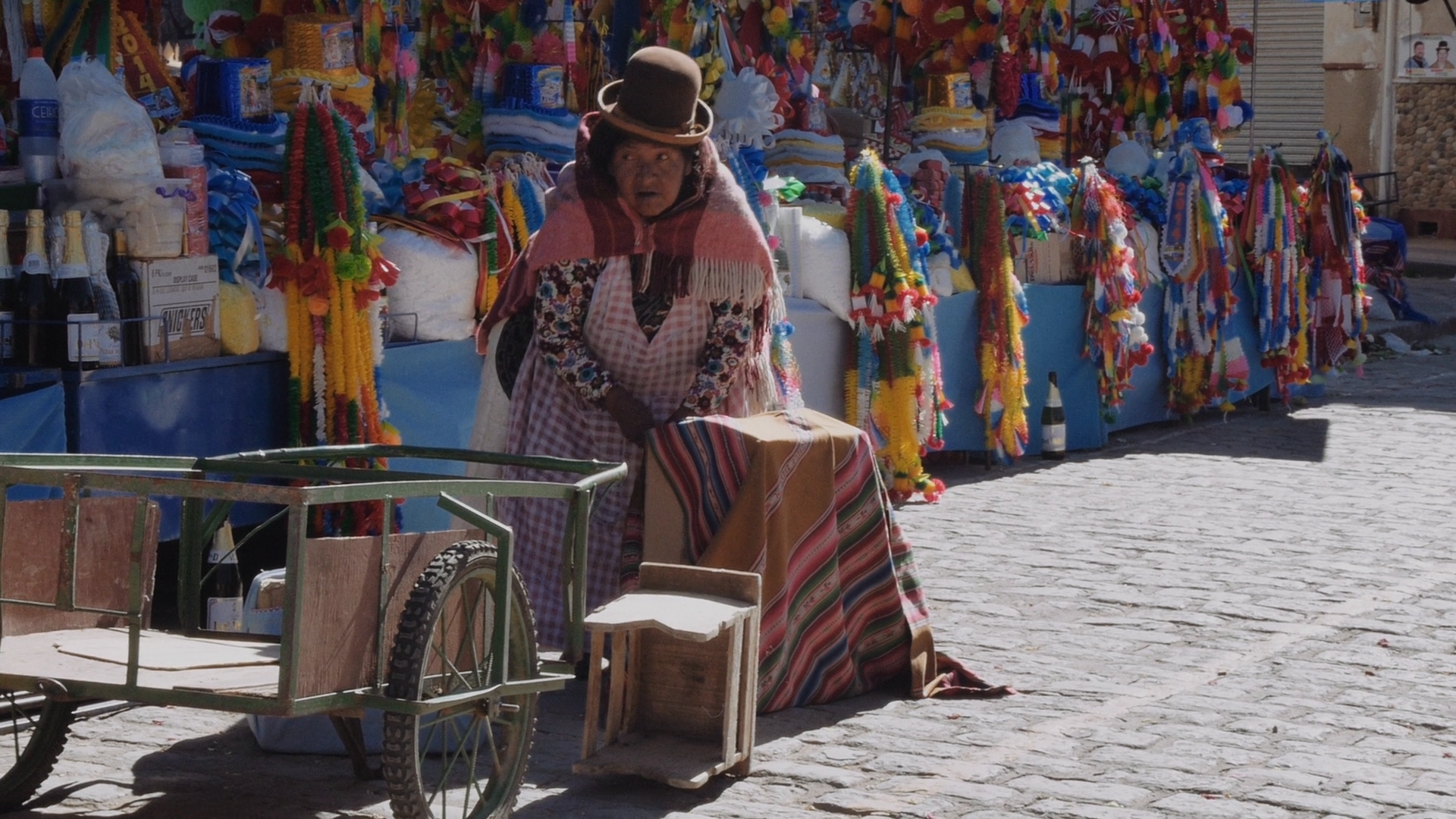

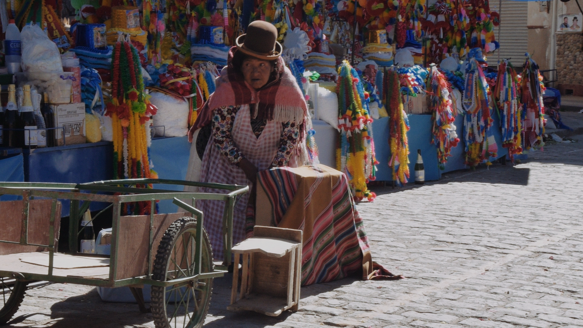

    TEST 2
    Master
Name:	Export Comparisons2.Master.png

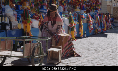

    MainConcept
Name:	Export Comparisons2.MCH.264.png
    x264
Name:	Export Comparisons2.HBx264.png

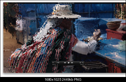

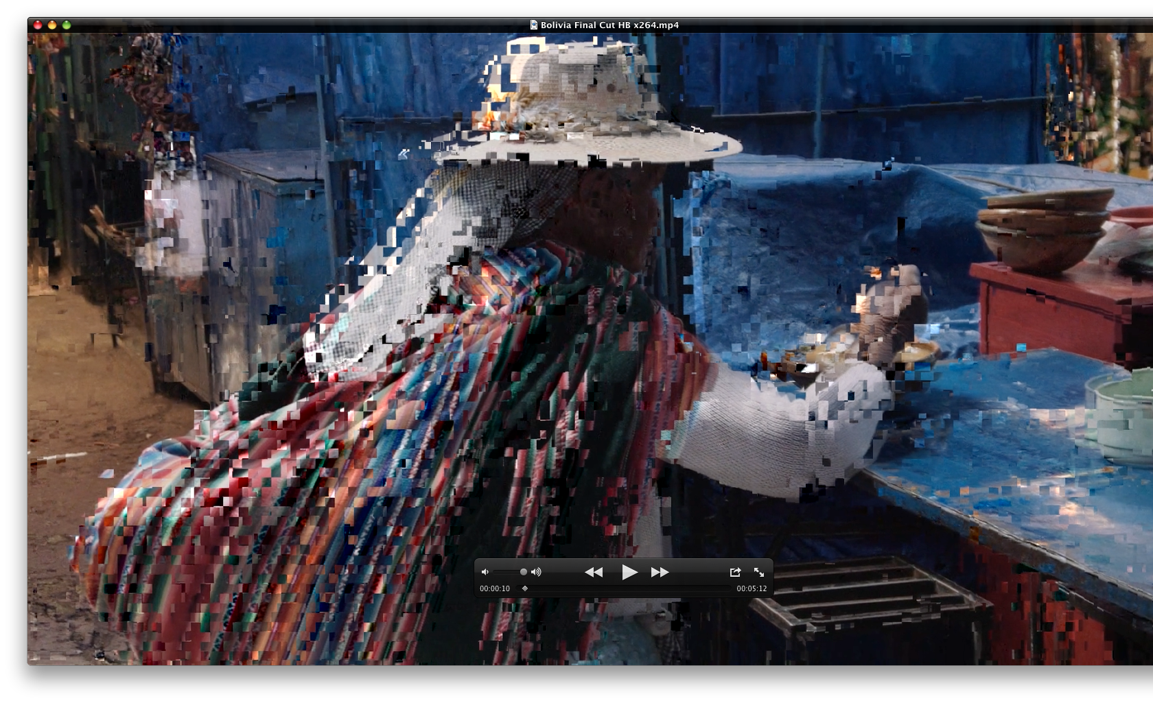

    Quicktime issues:
Name:	Screen shot 2014-12-28 at 10.52.27 PM.png

  9. 1) Double check with your festival submission guidelines - usually there are some restrictions or required formats that they stipulate. So you might need different versions for different festivals or youtube/vimeo
    2) Quicktime - QTX is an improvement over QT7, but still has problems .
    2a) If you need QTX compatibility, see this
    http://mewiki.project357.com/wiki/X264_Encoding_Suggestions#QuickTime_Player_X_compatibility
    Basically, since you used --preset veryslow, that automatically bumps up the reference frames and bframes to 8. Which is a problem in quicktime. You need to use --ref 4 --bframes 3 to ensure QTX compatibility
    2b) If you need QT7 compabitility, see this
    http://mewiki.project357.com/wiki/X264_Encoding_Suggestions#QuickTime_Player_7.7_compatibility
    Basically same as above, but also add --qpmin 4
    I haven't used handbrake in a while, but I think it has some QT compatibility presets ?
    3) Hopefully 3am Digital Studios is just on vacation and isn't ill or something bad happened ...
    And thanks for sharing your results! Good luck with the festivals! and Happy New Year to you too
