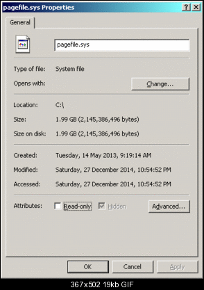

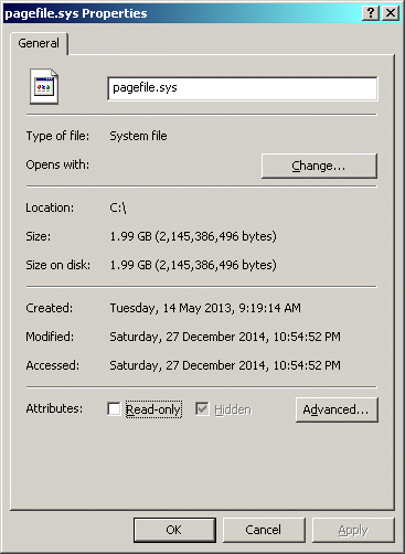

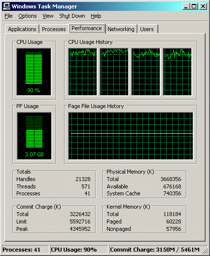

    I will confess I've never quite got my head around understanding page file usage. If the hard drive thrashes a lot, I assume it's being used too much. I wonder if cornery19's hard drive is thrashing away while he's encoding at less than 1fps?
    I just checked my page file size. It's 2GB. It's set to 2GB minimum, 6GB maximum. XP_PageFileMonitor agrees it's currently 2GB, but seems to think only 363MB of it is currently in use, and maximum page file usage since last boot is 770MB.
    Looking at task manager, it appears there's somewhat of a pagefile usage party going on. The hard drive LED is just flashing once in a while. I guess I don't understand all of the numbers, but how can task manager show 3.07GB of page file usage when Explorer says it's not that big? According to File Properties, the page file hasn't even been accessed in nearly two days.

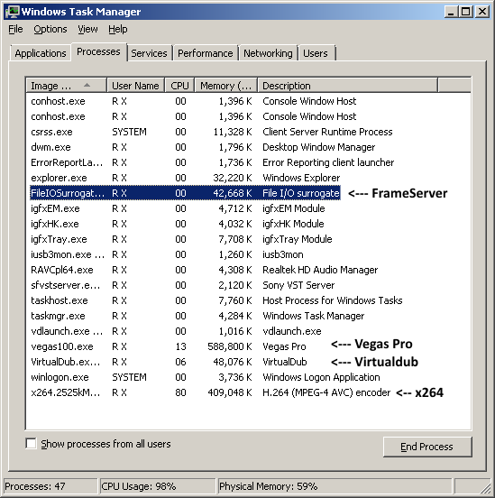

    Attached are the processes running while I Frameserve from Vegas to Virtualdub to x264. Notice that FrameServer and Virtualdub are light users, while Vegas and x264 are the heavy users. That's how it's supposed to work. Clearly the OP has other pressing issues...
    Note that I only have 4 GB or RAM.

  10. Originally Posted by racer-x View Post
    A voice of reason from beyond the "need more RAM" wilderness!

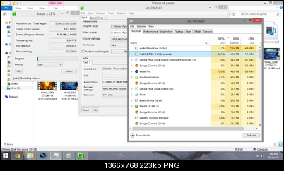

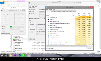

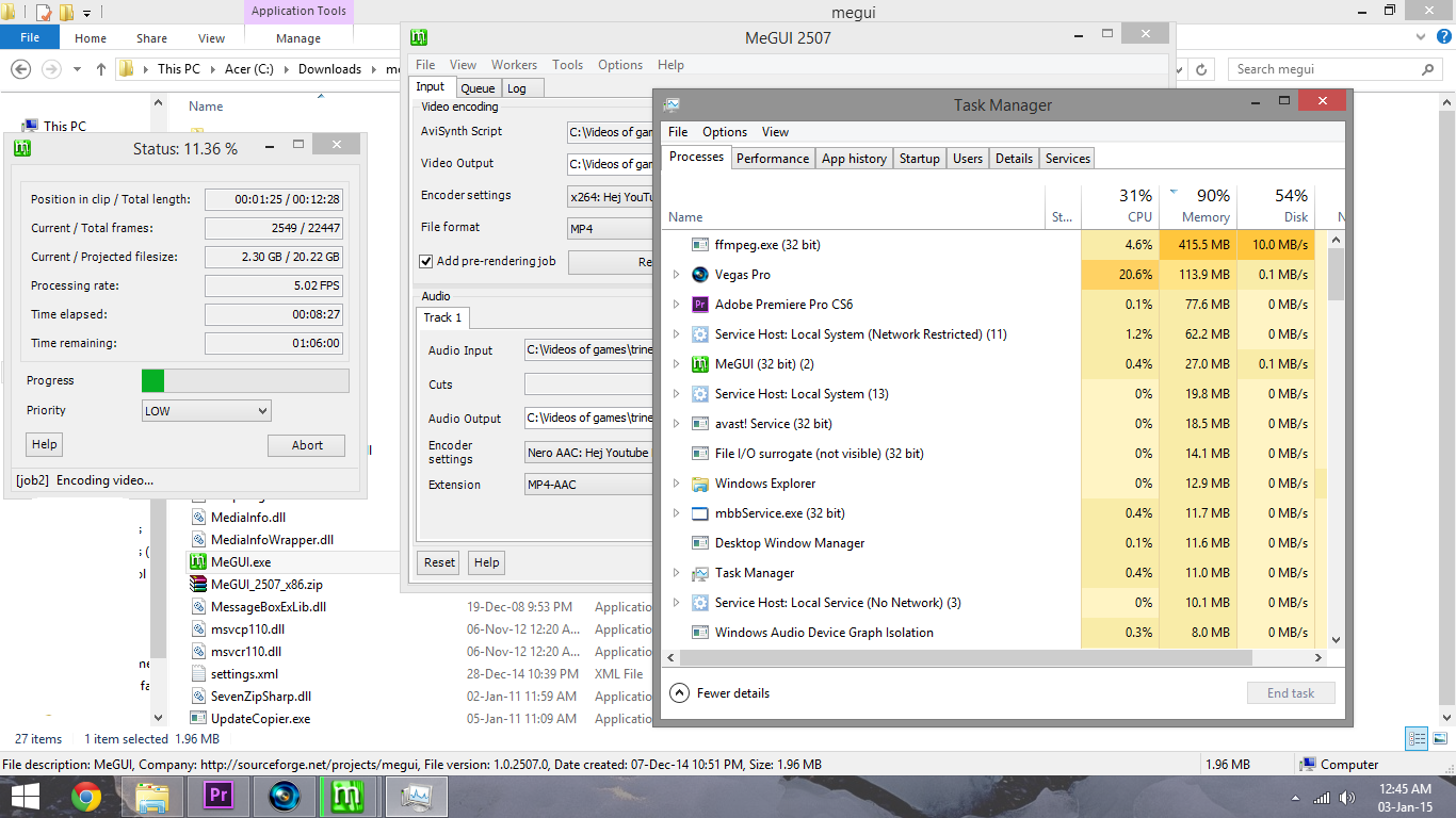

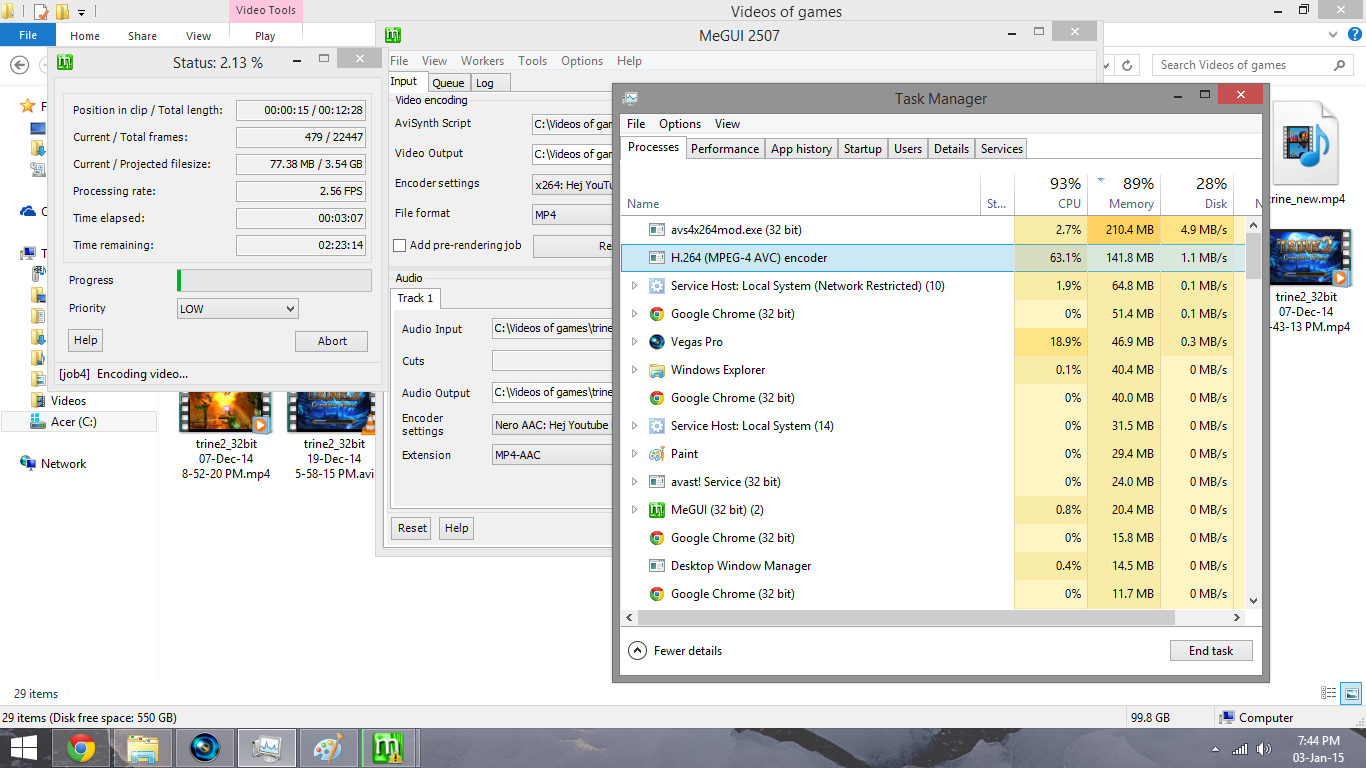

    I thank everyone who wasn't quick to jump on the " NEED MOAR RAM" bandwagon without trying to find other solutions to my problem too; yesterday evening while I was giving it another try something that pleasantly surprised me happened :
    5fps was the maximum speed I was able to achieve and it never dropped below 2 fps. As you can notice from the list of tasks in task manager, the avs mod isn't there anymore and instead it is replaced by the ffmpeg.exe . I have no idea what happened though, all that I had done differently than before is that this time around I had the "Add pre-rendering job" box checked.
    However, just for the heck of it, today I tried enconding it again, this time around without the "Add pre-rendering job" box checked and I encountered the same problem I had encountered before; even if the the fps averaged around 2.56, guess what? Avs4x264mod made a comeback, effectively eating up most of the memory.
Name:	without pre rendering job.png
  14. The pre rendering job uses ffmpeg to encode a lossless intermediate. It' s not actually encoding your final video with ffmpeg. Also , 5fps seems very slow for a pre-rendering job.
    But if you're going to do that, you might has well do it with vegas to a lossless intermediate instead of frameserving, that way you have less overhead , less memory consumption. Encoding from pre-rendered lossless intermediate will always be faster than frameserving through vegas
