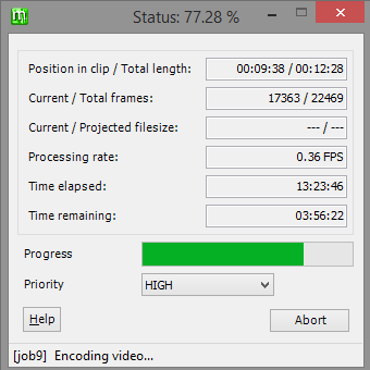

    Hi guys, here I am with yet another problem.
    I've been trying to render a video edited in sony vegas using the FrameServer+NeroAAC+ MEGUI method, basically as it is explained HERE . The problem is that MEGUI has been processing the a ///12/// minute video for more than 12 hours now and it's only 77% done. The processing rate is INSANELY SLOW at 0,36 fps and I have no idea what to do. The priority is set to high yet it's still taking forever?
    Does anybody know what might be causing the problem? Granted I don't have the best PC ever, it runs at only 4GB RAM with a core i3 @1,80 GHz, but come on, it can't be running this slow.
    A screenshot of the processing window for your thoughts

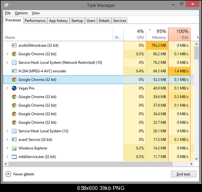

  5. Open up taskmanager, what is your memory usage during this ? You should close down unnecessary services and programs
    I didn't watch the video closely, but did you use the same encoding settings ? You can encode 10-20x slower or 5-10x faster by adjusting the encoding settings. There are severe diminishing returns once you get into the slower encoding settings - it's usually better to use a faster encoding preset and higher bitrate

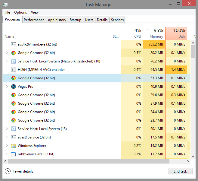

    my memory usage looks something like thisClick image for larger version

    Oh btw, major update. The processing fps has now dropped to 0.29. I've been processing this for 18 hours so far.

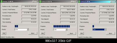

    You can start another encode while one is running. Add the encoding job to the queue, right click on it, and select "run in temporary worker". MeGUI also lets you add/delete "workers". The upshot being you can choose how many encodes to run at a time. If I'm using slow filtering in a script, I generally run two or three at a time.
    One "gotcha". The Abort button under the Queue tab aborts all running jobs, and right clicking on a running job and selecting Abort does the same. If you want to abort only one of the running jobs, you need to use the Abort button at the bottom of the appropriate encoding progress window.
    There's an option in the x264 configuration called "stitchable". It allows encoded video to be appended (assuming the same encoder settings). If you keep it checked, it can help to recover from accidentally aborted encodes.
    If you abort an encode before it's finished, you can open the output video with MKVMergeGUI and split it. Basically, you save it as a new MKV while discarding a section near the end, preferably at the beginning of a scene change. Then you can start the encode again from the point where you split it. The AVS Cutter under MeGUI's Tools menu lets you add "cuts" to a script so you can encode just the bits you want. When the remaining encoding has finished you can append the encoded video with MKVMergeGUI, add the audio etc, and save that as a complete MKV.

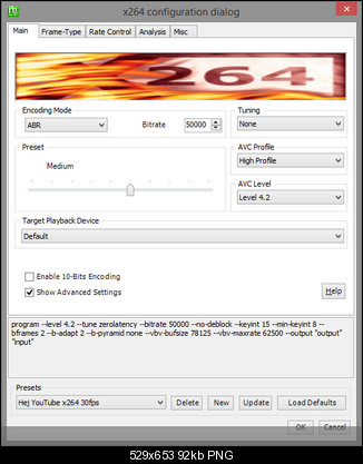

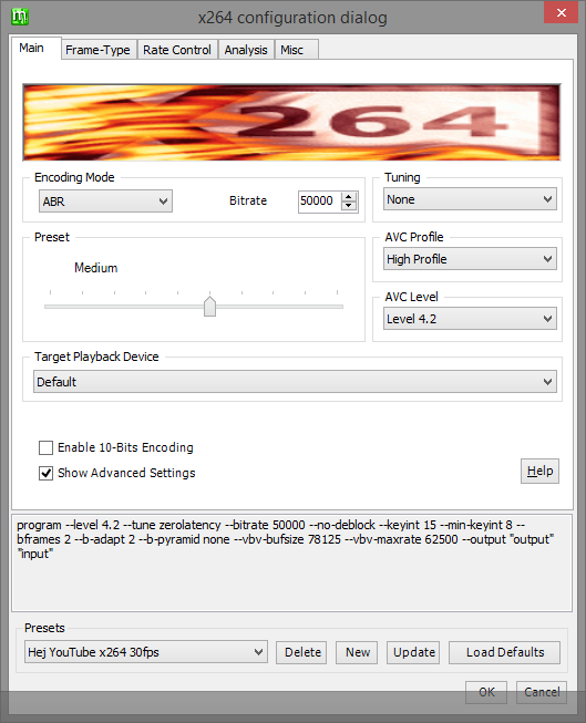

    This is what the x264 config window looks like for me. The settings weren't changed that much, except I have no idea what the stuff written at the bottom is.

    You need more memory. You don't have enough to frameserve from vegas. That's probably part of the reason - you're swapping memory to your page file

  12. Originally Posted by cornery19 View Post
    It's the commandline sent to the x264 encoder. If you change an encoder setting to something other than the default value, it'll be added to the command line. Keep in mind, the x264 speed presets are just different configurations of x264's advanced options, so when you change a speed preset some of the defaults for the advanced options change accordingly. As an example:
    Open the x264 encoder configuration, load the defaults, check the "show advanced settings" box, and under the Frame-Type tab, change the number of Reference frames to 5. --ref 5 will be added to the command line. Now change the x264 speed preset to slow. --preset slow will be added to the command line. If you go back to the Frame-Type tab and check the Reference frame value again you'll see it's still 5, but it's not added to the command line any more as --ref 5 is the default for the slow x264 speed preset. Hopefully that makes sense.....

    4GB is really insufficient for video processing. I would recommend 16GB or 8GB if you want to push it to the minimum.
    Memory is cheap you can easily get 8GB for under $75, that's 21 grande lattes at Starbucks.

    4 GB Ram may not be ideal, but it is perfectly usable. That's what I've been using the past 6 years in fact. Just to prove the point, here is a live screen recording while I edit 4k HEVC 4096 x 2160 @ 24p on my old Q9300 with 4 GB RAM. I left the Sys Monitor running for referance....
    https://forum.videohelp.com/attachments/29132-1418585754/4K_HEVC_edit.mp4
    This guy's problem is "avs4x264mod.exe" (whatever the hell that is) is sucking up all his memory. Probably some kind of leak.

    95% memory usage is going to slow down your encodes eitherway. It might not be the only factor, but it's definitely contributing. The way windows handles memory is it swaps out to the page file even around 50-60% usage (probably even lower). Even if you have a SSD for your page file, it's going to be slower. A mechanical HDD will be even slower
    Frameserving adds overhead. Avisynth (which is a frameserver too) adds overhead . All those things add up. But a large contributing factor is the memory consumption

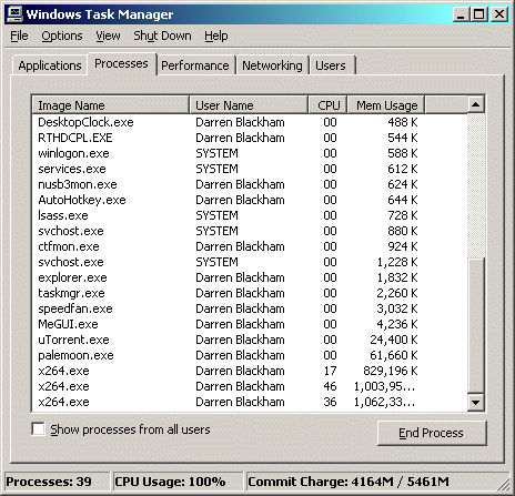

    When encoding x264, your CPU should be maxed out, not memory. Your CPU is only at 4%.
    Look for anything you don't need running and kill it off. Example Chrome and your antivirus.
    Here is my screenshot while frameserving from Vegas to Virtualdub and encode to x264 + aac .mp4

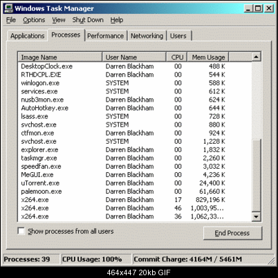

    I subscribe to the school of thought that memory not being used is memory being wasted, but it doesn't necessarily mean it's required. Even the paging file..... programs ask Windows for memory and it tries to give them what they're actually using from RAM and it assigns what they're not using to the paging file. That keeps the programs happy but it doesn't mean the paging file is actually being used for data.
    I've never used Vegas so I can't comment there, maybe it's a hog, but I regularly run 2 or more encodes with QTGMC in a script, while watching a movie and browsing this forum. I have 4Gb RAM (3.5gig available to Windows). Sometimes a new movie is a little slow to open, and sometimes if I've got lots of tabs open and haven't used it for a while, the browser takes it's sweet time coming back to life, but none of that seems to put much of a dent in encoding speed. It stays pretty steady.
    Page file is always used for data. Even if you disable it. Even if you had 60% usage, in theory, it could keep everything in DRAM, right? But Windows doesn't it actively swaps. For him, at 95-100%. Now that's going to be a problem.
    Well how nice for you, but you're not at 95-100% memory usage. This is called a "bottleneck". Why do you think this CPU usage is 4% ? x264 is starved for data, waiting ... idle...
    x264 has a lookahead function that gets larger with the slower presets. It stores frames in cache and "looks ahead." x264 by itself should take ~1GB on medium, maybe ~1.2GB on slower for 1080p . So the faster the preset, the less memory usage as well. Avisynth also caches frames in memory it gets larger with more functions, more complex scripts
    MeGui is spawning avs4x264mod.exe. I wouldn't bother with frameserver or megui in a low memory situation . I would export a temporary lossless RGB intermediate, close vegas and everything else, then use that as input file to x264 directly. x264 builds can be complied with avs support directly
    (You need to use avisynth, because vegas , in 8bit mode will be using "studio RGB" for the conversions to RGB if you had YUV input. You to essentially reverse that by using PC levels in the script)
    I'm not convinced the page file is always being used for data, even when it's being used as such. Windows thinks unused memory is wasted memory too. It tries to use it all, so unused memory assigned to programs is allocated to the swap file. That way, RAM isn't wasted.
    I wasn't using 90% memory, so I started a third encode. Memory usage for the first two has dropped a bit. It was shown as around 1,100,000 each before I started the third one. I'm still browsing. I'm still watching a movie. uTorrent is still downloading. I'm saving screenshots. This is an old Q9450 quad core. It's feeling less responsive, but encoding speed is still normal..... for single threaded QTGMC.
Name:	task manager.gif
  26. Originally Posted by hello_hello View Post
    Are these 3 SD QTGMC encodes with the same settings? It's definitely not "normal" since all 3 have different encoding speeds. A 58% difference from fastest to slowest is significant difference wouldn't you say ?
  27. Originally Posted by poisondeathray View Post
    Even when everything is the same, encoding speeds are rarely identical when using QTGMC. Maybe it's to do with process priority, or sometimes the phase of the moon.
    The first was QTGMC de-interlacing with some noise filtering. Two and three are QTGMC in progressive mode. I aborted number three after posting. Number one is currently plodding along at 7.08fps. Number two at 3.80fps. So I lost 3 or 4fps by cancelling the third encode and the first gained 1fps as a result. CPU usage is currently sitting on 86%. You've got to admit, speed differences aside, I'm still nowhere near 4% CPU usage bottleneck territory and less than 1fps encoding speed. And remember, while his encode was crawling along cornery19 ran a (simultaneous?) test encode which ran at normal speed, despite the fact I'm fairly sure it'd use RAM too. I agree cornery19 has a bottleneck somewhere, but I'm not convinced its a lack of memory.
