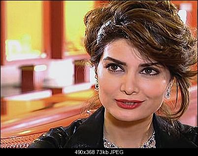

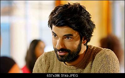

    First, i need to know how to do all MeGUI configuration. Second, i record from TV which means i do SD and HD..., the main thing i want is how do i make SD quality better to watch? Which filters do i have to use.
    Look at these two screens, the first has been recorded from HD channel 1920 * 1080 and it turned to SD 656 X 368
    And the second is originaly SD...
    How can i make mine better?

    @yaston, others have asked for more information about the videos you work with. hello_hello asked for a copy of the script you are trying to use. No one here understands what "I failed !!!" means in any technical way. What error messages did you see? What script did you use? We have no video sample, no script from you. There is little we can do with no information or with cropped, resized RGB images.
    Like hello-hello, I see nothing wrong with the color or levels in the top image you posted of the old woman. We don't know how it looks in the original video because the image has been processed. Except for too much sharpening it looks "normal" to me.
    Your second image above of the young woman is too bright. Contrast Levels and color values exceed video standards. It is too red and too saturated. Did it look that way in your original video? We have no way of knowing. Below, I made corrections entirely in VirtualDub with levels, saturation, and gradation curve filters. But I am working with a processed and cropped still image. You cannot use the same filters in the original video.

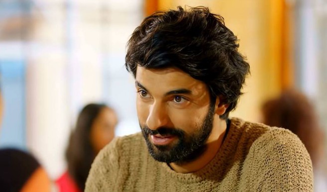

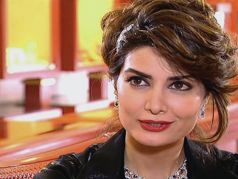

  12. These two pictures are not mine, i just found it and i liked the filters that the encoder used in. i need to know which filters he used ?
    If i show you other picture you'll see, take a look:
    All of these pics are smooth and face color is brown, i need just to which filters i have too use to get a ggod qyuality

    Sorry, but IMO those images look like typical processing errors. They are over filtered and over sharpened, and red and green are too saturated. They look plastic, or like 3D computer animation. The skin tones aren't brown -- they're orange. You can make videos appear any way you want, and perhaps other readers will be willing to teach you how to make eccentric color effects with video. But they won't help you if the only samples you post are still images.
